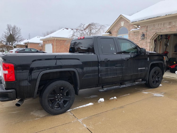

Haven't really done anything in a while, but finally got this in the mail! I went back and forth forever on whether or not I wanted to add mud flaps because I really liked the look without them. However, I really wanted to protect the bottom of my doors so I took a risk. I went with the Weathertechs because they were very subtle and an easy, no-drill install.
I took an additional risk by only getting the fronts, I just didn't like the look on the rear of the truck and I think the chip guard on the back of the bed has been more than adequate against debris. I am very happy with how they turned out!! Extra plus is that I can remove them whenever I want in a matter of minutes!

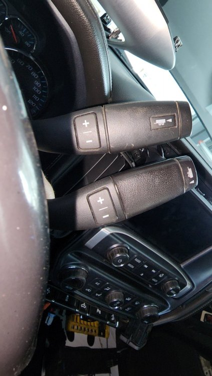

Making progress slowly swapped out shifter for the denali one. Changed door sill trim. Got the back seat in. Center console not mounted yet need to get the harness for it.

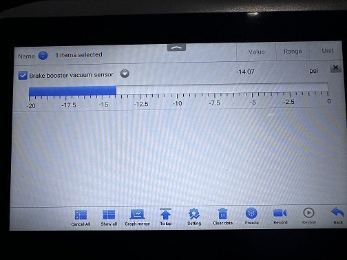

While I was at it, I addressed low psi in the brake vacuum, by replacing the vacuum pump. My truck is an 2018, but had older part number (12669488). So I got new one from Amazon (100$) part # 12696313. Checked Brake Booster Vacuum before at idle: ~12psi, and dropped to 1-2psi on peddle pump. Checked after: 14psi at idle, and 3psi on peddle pump. Not much difference, but the pulley bearings were going bad, and I replaced the belt, so still worth it at 80k.
