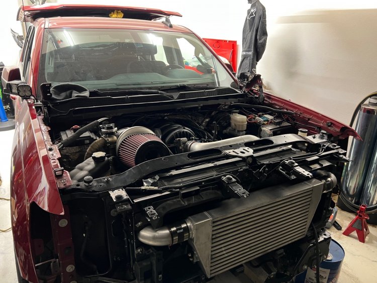

Got to put in a few hours today. Still need to put the drive shaft back in and just button up all the little things. Few more hours sometime next week and it should be back to life!!!!

Had some time today so I decided to finish up the truck. Good thing i didn’t rush to start it yesterday. The wastegate line was hook up wrong. Here’s a quick little short on how it sounds. Haven’t really got on it yet. Gonna give it at least 500 miles of break-in.

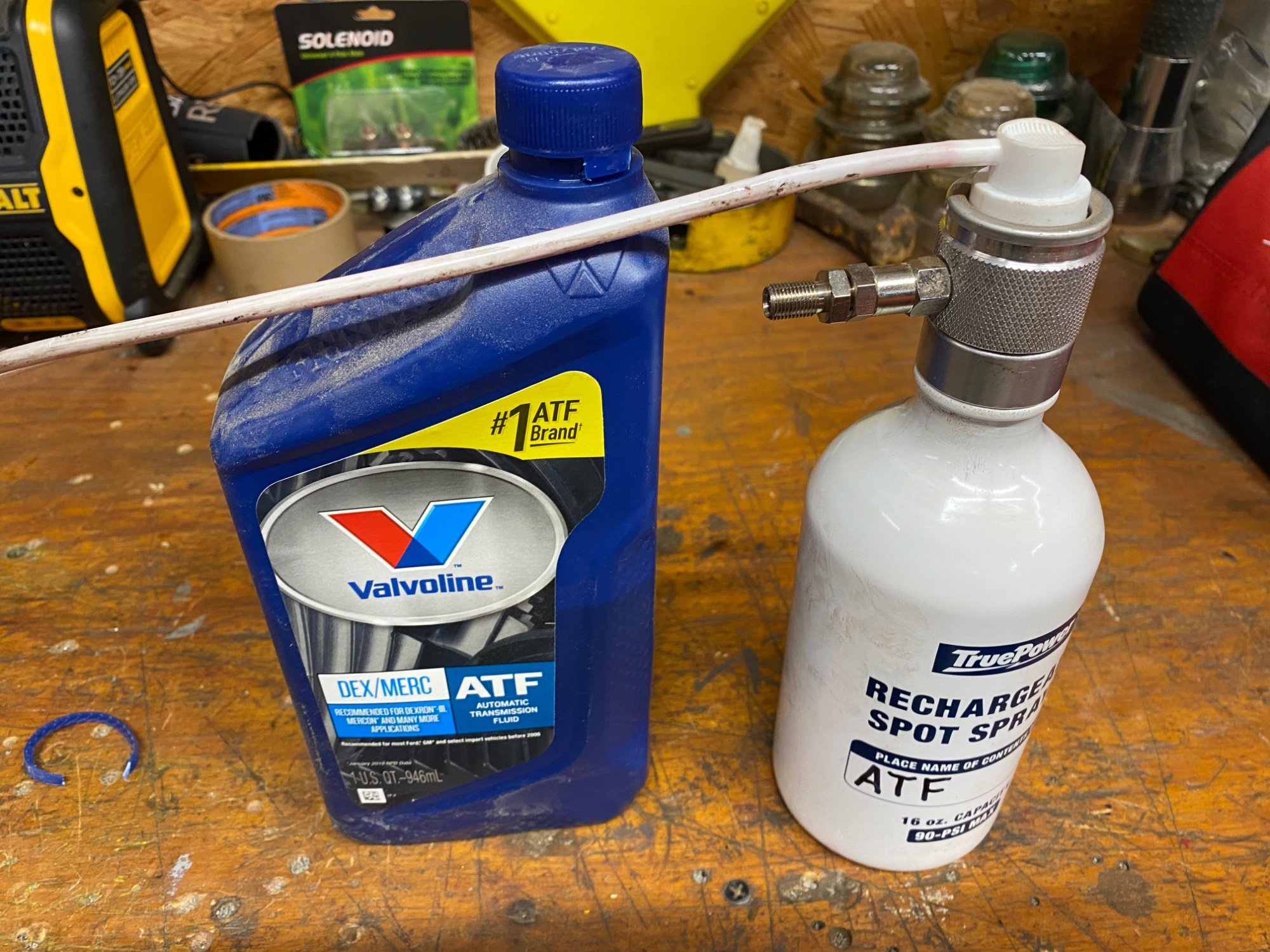

Cleaned up a few rust spots on the frame and hit them with some Rustoleum Rust Reformer and satin black paint. Did the same thing last fall and those spots still look good. Coated inside the frame and crossmembers with Dexron 3 ATF to hopefully keep the frame from rusting from the inside. Used a rechargeable sprayer and a 2’ nozzle that came with the cavity wax I sprayed inside the body panels. 3463319D-A15D-4B93-8003-DC66662BB515.thumb.jpeg.2821dce72fa0d6c5444aeffd90400bca.jpeg
