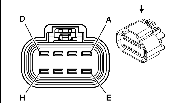

If G (wire) in the headlight plug runs the DRLs, couldn't you install a diode in that wire to render them off all the time..........or (cut the wire and tape it up, if you desire)....?
Also, the wiring manual shows G to be the wire on both plugs (right/left)....
