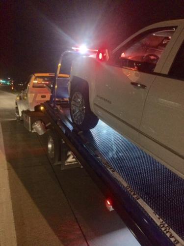

One way to get your dealer to take your powertrain complaints seriously is to have it stop functioning completely at 4000 miles. I had to have mine towed to the dealership last night, because I couldn't get the thing to move after I stopped at a busy intersection. Imagine how embarrassing it would be to have your brand new $50K truck rendered completely immobile in a busy intersection. I was able to push it across three lanes of traffic, and to my luck, the tow truck operator was a Ford guy; told me he "loves picking up these new Chevys."
I tried everything I could think to do - shifting to reverse, shifting into 4L, nothing. I was able to wiggle the negative post off the battery and kill all power. I let it sit for a minute, but when I fired it up it was the same deal. I'm not sure if I have a shift control solenoid issue or my whole tranny got ripped through in 4000 miles. I find the latter to be less likely, but either way, I'm currently waiting on the dealership's prognosis.
Just an FYI it is a 2016 LTZ Crew Cab Z71 with an 8-speed & 3.42 rear end.
