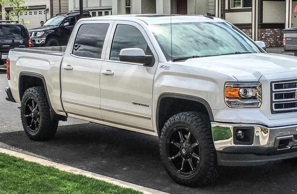

I have 20x9 fuel Mavericks +20. Any idea if 33x12.5 will rub too much?
I have the same setup (33x12.5 -19) but I have different wheels and tires. That's a good lucking truck!!
Edited by GMC207
To be honest I'm not 100% but I can say that I didn't rub too bad but still trimmed plastic. With your offset I would think you would clear suspension and would just be rubbing plastic if anything.

2. I have the RC 2.5" level and 20x9 0 offset rims with 295 55 R20 tires. The only rub I get is on the driver side in reverse on my mud flap. If the mud flap wasn't there it would clear. Having said that, you'll be fine at 0 offset, and at +14 offset you should have even more clearance. As far as I know, negative offset is where you run into rubbing problems, so going up in offset should give you more room.

You think I would clear with no rubbing at all on or off road, or full crank with +18 295/55r20? I will go 285/55 if I have to but I just want the tires at minimum flush or slightly poked from fenders and I am worried 285 at +18 offset won't poke and I think 295 would just overall look better.

yes you should clear easy. At 0 offset my 295's poke out about an inch. +18 will probably exactly even with the wheel well I'd guess. you could always get spacers if you're not happy with the stance
