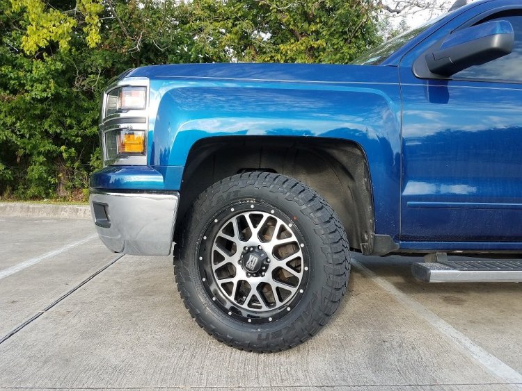

I hear ya man, ya I was all about 4.5 - 6 inch lift as soon as I snagged my rig as well lol. I'm really glad I just went with a 2.5 lvl. I have young kids and pull a 21' scout all over the planet. So a lol for me was more practical. As for your wheel and tire dilemma, I am running a 20x9 0 offset with a 295/55R20 Ridge Grappler. Actual measurements are 32 7/8" tall and 12" wide. I get only slight rubbing on the plastic at the back of the fender at full lock with a touch of articulation. My setup sits as flush as can be with only the sidewall outside the fender. I like this because the water base paint that the EPA now requires will vacate rather quickly without fender flares lol. I hope this helps brother.

Just got new tires, Falken Wildpeak AT3w's, 305/55/20. So far, have about 400 miles on them and they ride great! Rubs only at full lock when in reverse, nothing major and I haven't trimmed or tied anything back.
