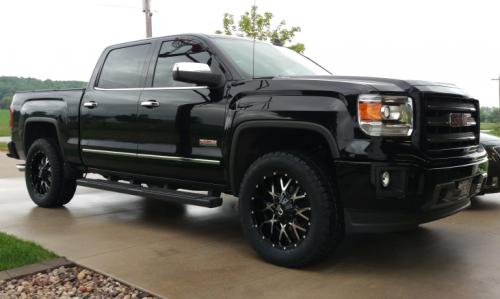

Here's mine on 20x9 +20. 295/55R20 Trail Grapplers. No rubbing.

Your truck looks SICK! What model was you leveling kit that you used? im looking to do this same set up. Thanks!
Thanks! That is the Rough Country 2.5" kit.
Your truck makes me wish I had bought a black one.
@Enthusiast...very nice truck! How is the noise?
I cant speak for @Enthusiast but IMO the tire noise for any tire on these trucks are less due to the new cab design and sound deadening engineered in these trucks. I don't even hear my tires till I get over 80 but I run a different tire. From experience I think the Nitto Trails are pretty quiet for how aggressive they are. Same goes for the Toyos. Although these are mud tires not ATs.
