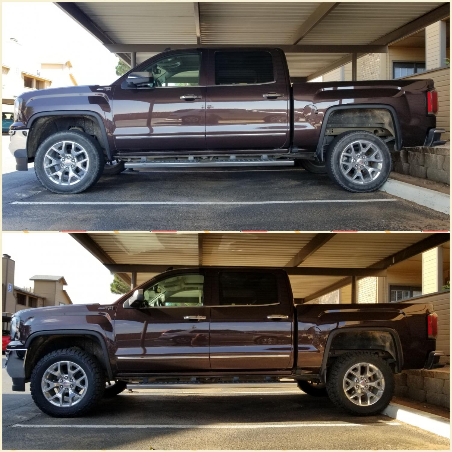

I have a 2.5 inch RC leveling kit on my 2016 GMC Sierra 1500 6.2L and decided to go with 305/55r20 after reading this thread. The tires I decided to go with are the Bfgoodrich KO2's. I am completely satisfied with my decision even with the loss in fuel mileage. I have not put a calculator to it and am referencing the fuel mileage display. Please be aware that even though I have a leveling kit, I later decided to install helper springs that sometimes raise the rear-end depending if I will be hauling a load. There is also rubbing when you lockout but it's minimal and no trimming is required.post-176953-0-28603700-1504921466_thumb.jpg

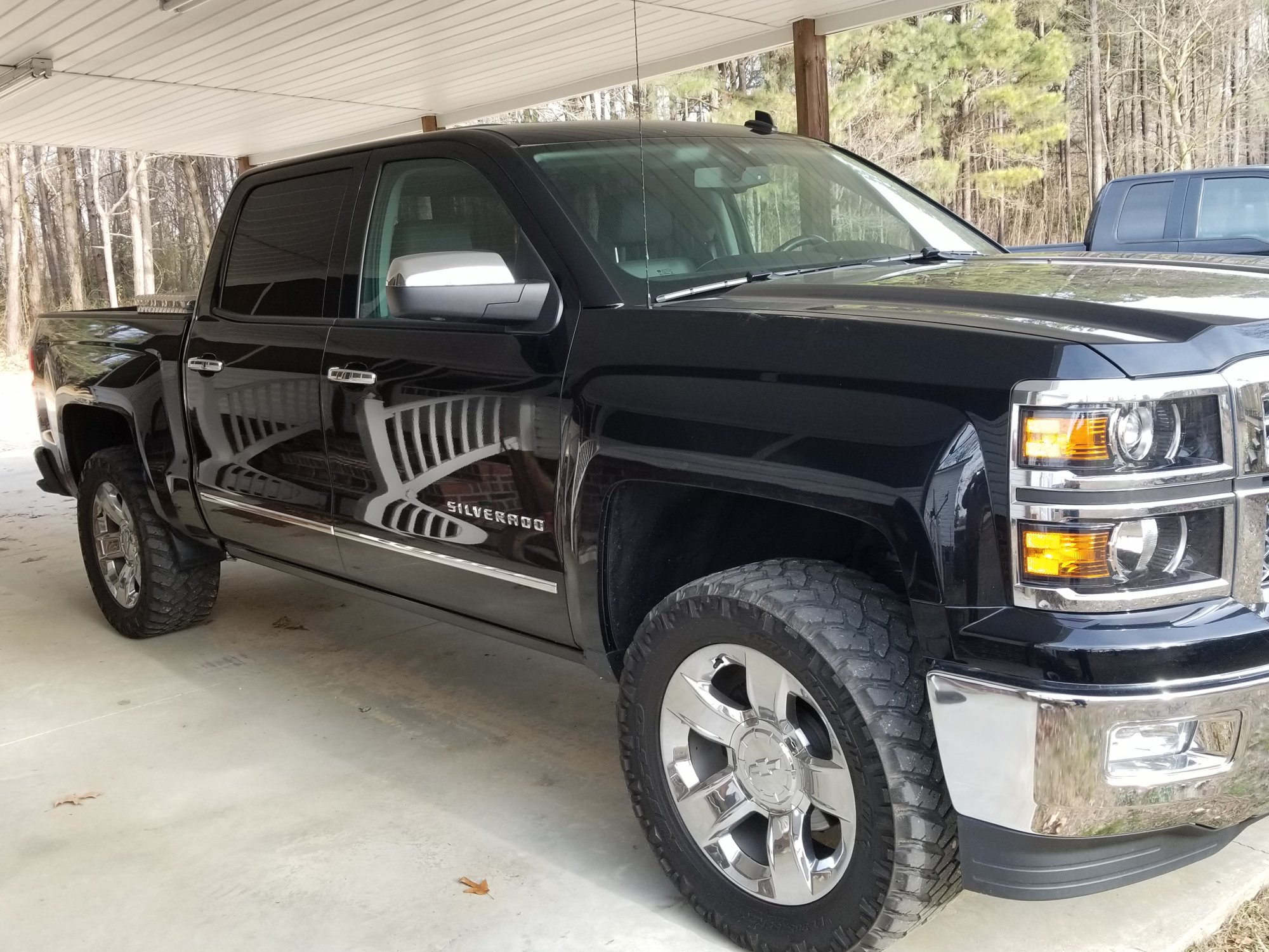

On 1/26/2018 at 2:01 PM, Carson west said:
2014 ltz on 305/55/20
I have 2018 ltz with the same wheels and I want to run 305’s. I ordered a motofab 2” leveling kit, the one that goes in the bottom of the strut. What lift/level are you running and are your tires rubbing.
