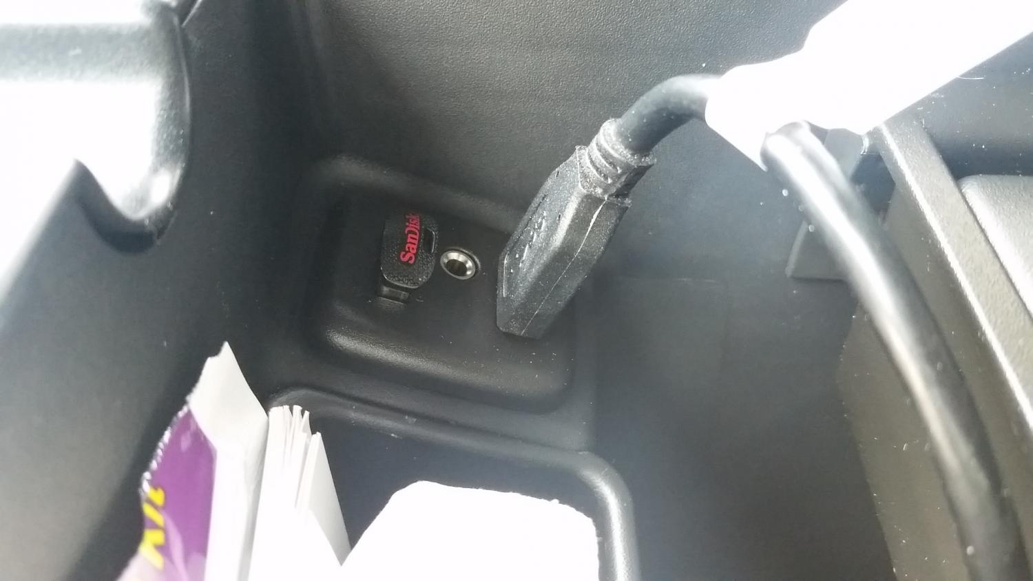

Here it is in action with my San disk mini 128 gb thumb drive.
FYI the left steering wheel button switches movies and the right steering wheel buttons change the volume.
Also, someone had asked, if you long press the forward and reverse buttons on the screen, it will indeed fast forward and reverse the movie.
