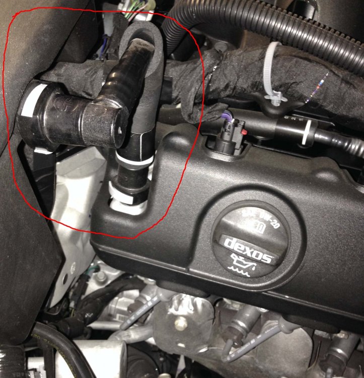

I'm looking under the hood on this thing and although it is difficult to see much it looks like there are two PCV valves, assuming that's what I think I'm seeing.  They are right up front of the engine, one each side, with short tubes going into the intake air plenum.  See attached photo of the front left side of the engine.
So question #1, are two PCVs what I am seeing?
Question #2, if so then I need either two catch cans, or one that does double duty, right?
I'm a little confident that the answers to my questions will be yes (still appreciate confirmation though) and if so this will be a plumbing nightmare.  This truck has the eAssist which means the only open space for a can is the front left corner where the battery used to be, on eAssist it's up in the back right corner of the engine bay.  And, there is no room at all left in that part of the engine bay, it is packed.
So I guess question #3 is, anyone come up with a creative way of solving this problem, besides hoses all across the top of the engine?

There are two options with catch cans; 1 port or 2 port. The single port will pull from just the crankcase as what is typical. The 2 port version taps into the clean air side which is what the two lines are up on both sides of the plenum. The clean air version is for low vacuum events such as full throttle or long hill climbs while towing. You’ll have positive crankcase pressure during those times without sufficient intake vacuum to evacuate the crankcase. In those situations crankcase vapor flows out and into the clean air side of the air intake which can pull in oil mist as well. The 2 port catch cans tap into that.
The can can be mounted on the brake booster which will also keep the can warm since it’s so close to the exhaust manifold. This will also help evaporate the water that collects in the can so it won’t fill up as fast.
