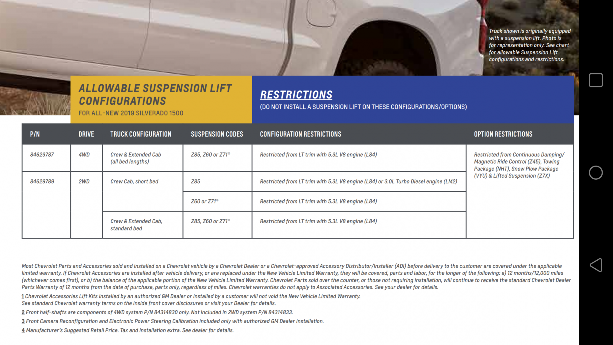

Yeah, did anyone figure out why the LT w/ 5.3 is restricted from this?
This ^
I’m curious as well. Is this a matter of that it physically CAN’T be done or that GM WON’T do it because of losing sales on the LT trail boss?
I have a LT Z71 and as far as I know, there are no differences between the Z71 suspension on a RST, LTZ, or HC which apparently can have the trail boss lift kit added per GM.
I’m quickly losing my patience with GM and  all their BS.

The kit seems complete. Still, GM says the TB lift kit can’t be installed on an LT with the 5.3L engine. Still waiting for answer as to why but I suspect it’s only GM keeping people from going a cheaper route than buying a LT TB from the factory.

So just to verify. Can this lift be used on the RST 5.3 non Z71 trucks?
Yes. Pretty much every Silverado model, trim, and engine EXCEPT the LT with 5.3L.
Ive attached the guide from earlier.

Well, looks like you’re right. I found this link: https://media.chevrolet.com/content/media/us/en/chevrolet/vehicles/silverado/2019/_jcr_content/iconrow/textfile/file.res/2019-Chevrolet-Silverado-1500-Product-Guide.pdf
Says “composite second-stage rear leaf springs on LT models”. So GM gets off the hook for what looked like a marketing ploy. It still doesn’t specify if this is for all engine combinations or just the 5.3L.
But why just on the LT are there composite rear springs? For a softer ride? Weight savings? What? Like I said before, I really would have figured the LTZ or high country would be the ones with a composite.
I’ll physically check my truck in the morning but looks as though I’ll have to buy Custom/RST/LTZ/HC leaf springs if I want the TB lift. Ugh ?
