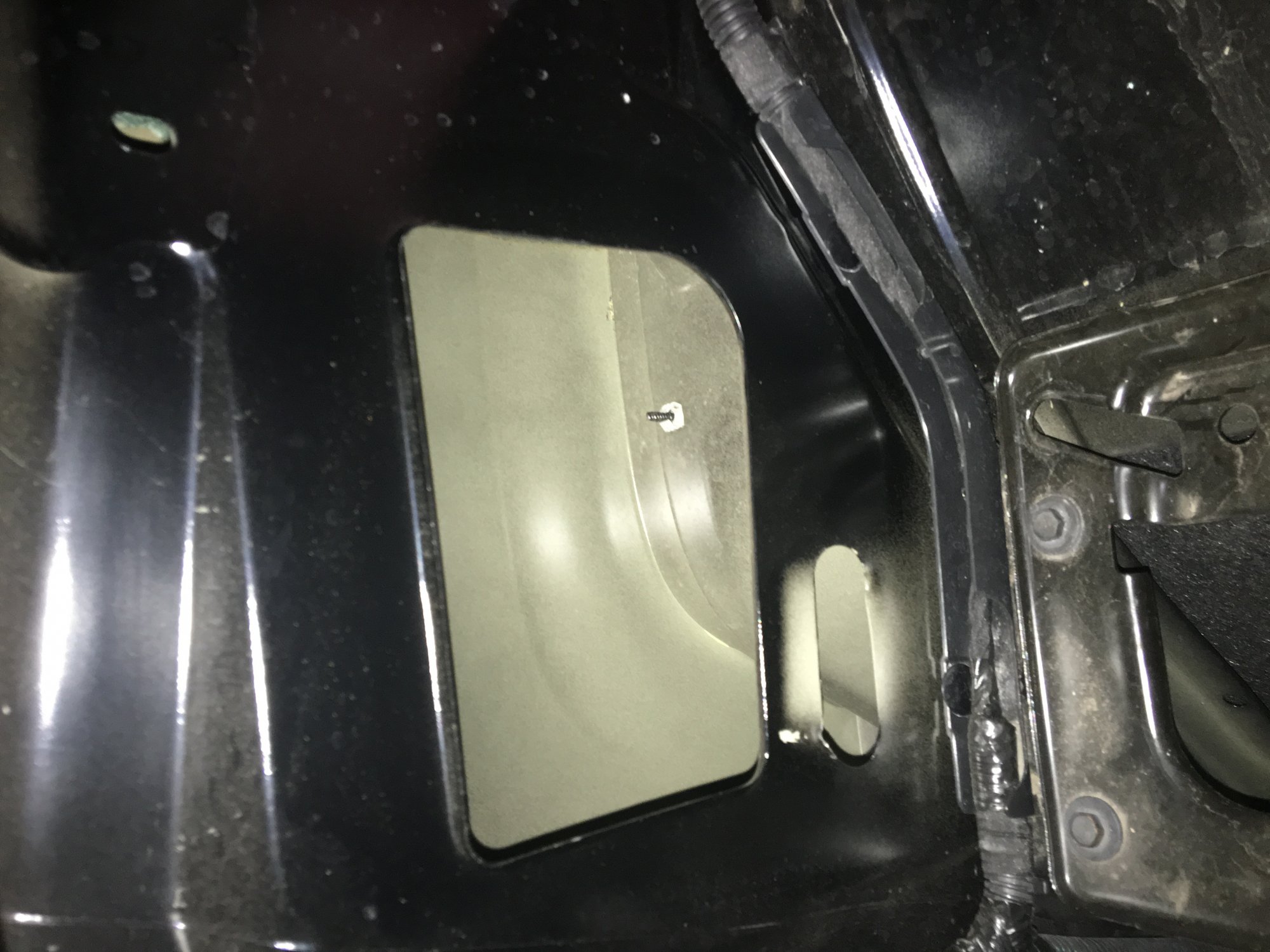

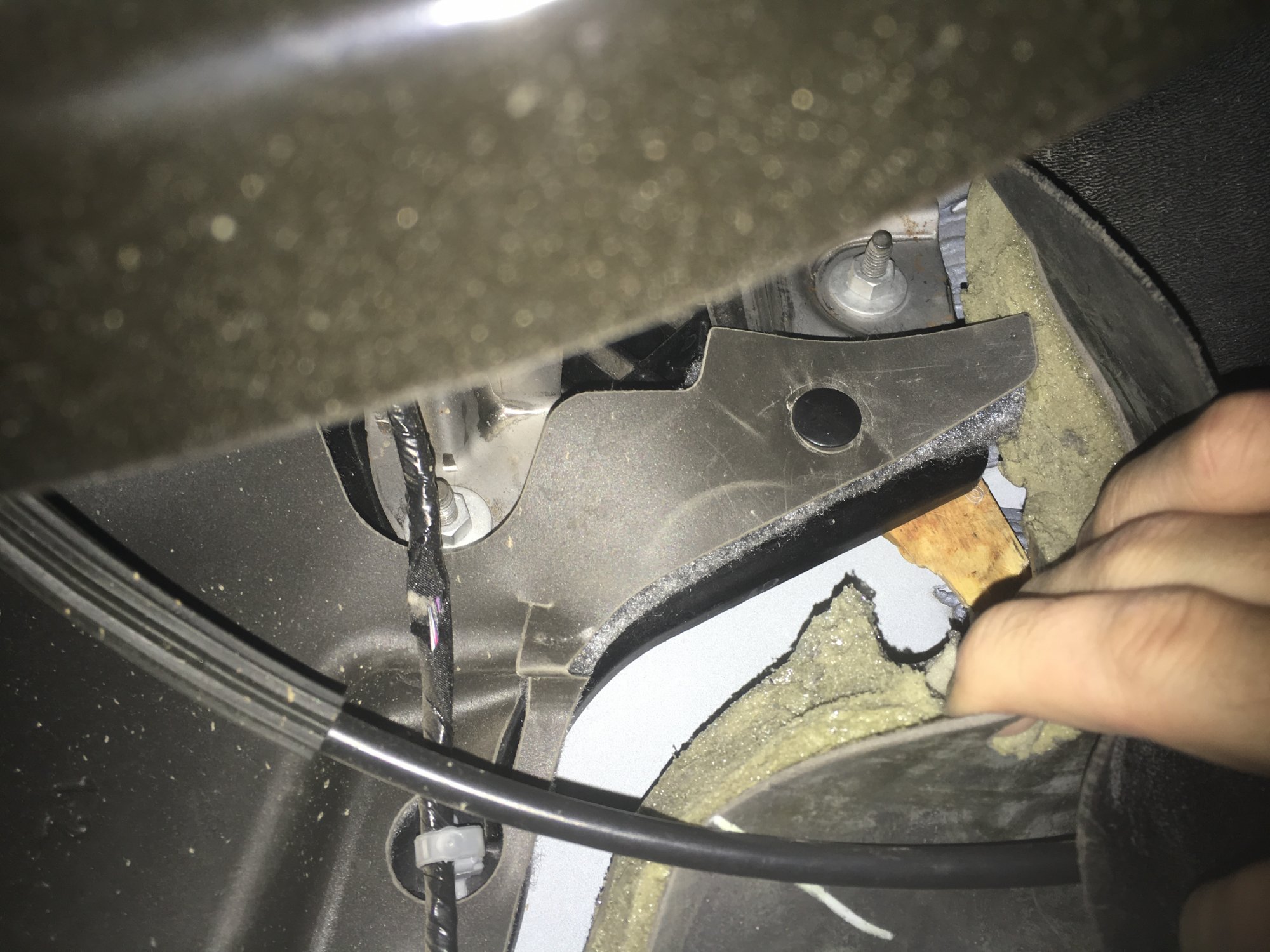

The hardest part was removing and replacing the airbox. Other than that, took about 3 mins with a hole saw drill bit and jigsaw. Haven’t had a chance to drive it yet.

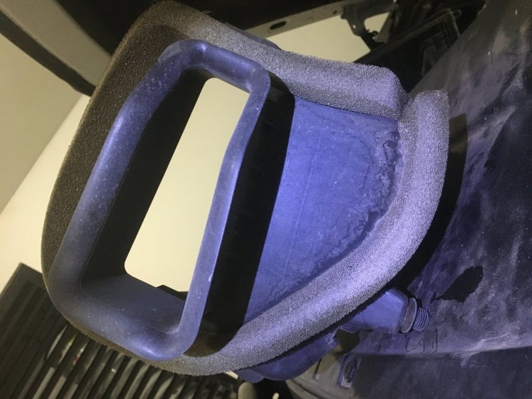

In the 2nd photo (with the foam), I cut out the smaller oval. There’s a formed pattern on the backside to follow and it lines up perfectly with an oval cutout inside the fender. Not a huge additional opening, but if it adds 10%(?) more air flow - why not?

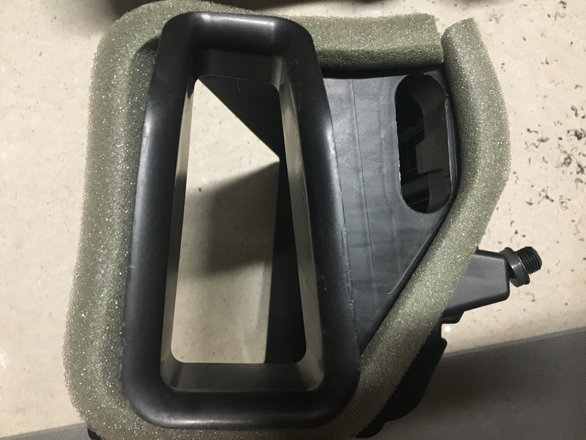

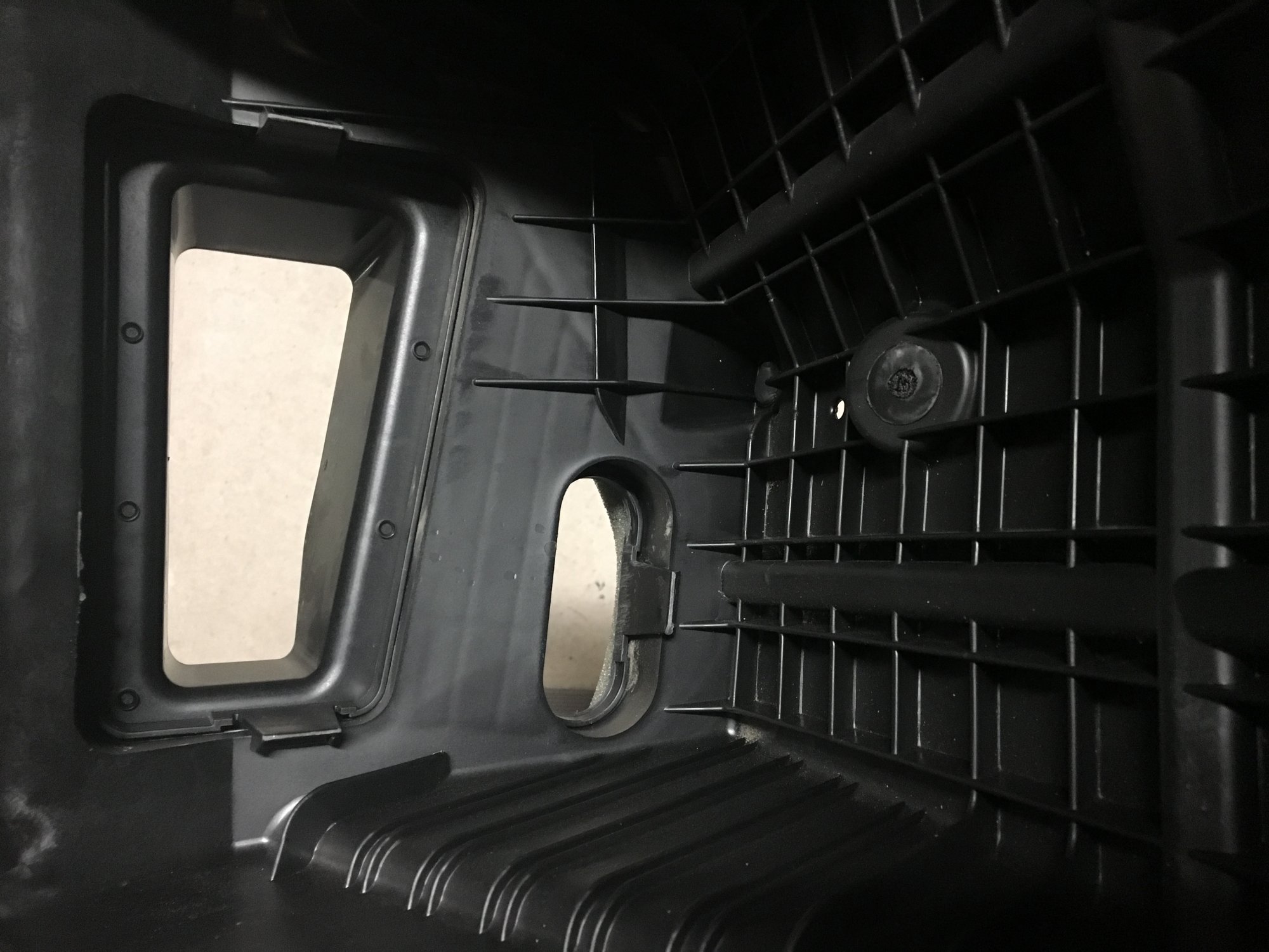

Here s a photo of before and after of my airbox
You cut it open under the airhorn

And here’s a shot of the inside of the fender... this was meant to be!
