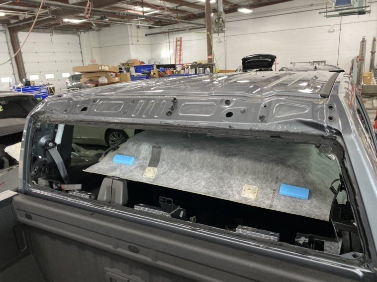

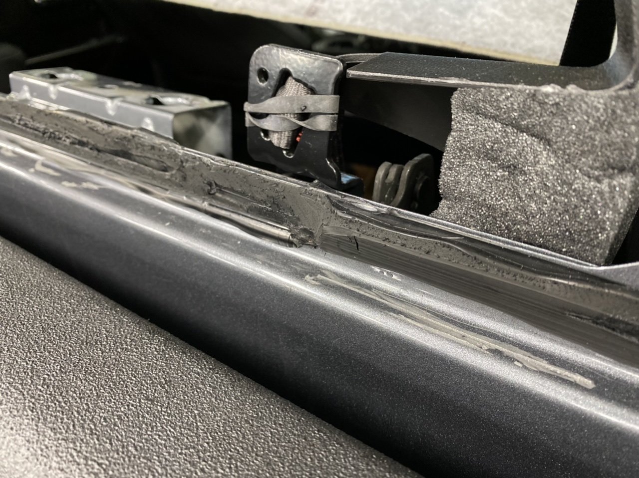

For those that are following along -
had a rear window replaced and the paint was scratched down to the primer so the window came back off today.  Taken to body shop for repair.  Well, underneath the window unknown to anyone, there was actually a violation of the primer coat so a great way to let rust form in the cab around where the window was removed.  I got to watch the whole process, looks fairly easy to rip that paint and primer up with some of the tools, so anyone with a window replacement should probably watch vigilantly for rust issues at either of the lower corners of the window.
picture for attention.
That looks like a disaster. Thanks for the heads up, I'm currently waiting on a window. How long did you have to wait on your window to come it?
