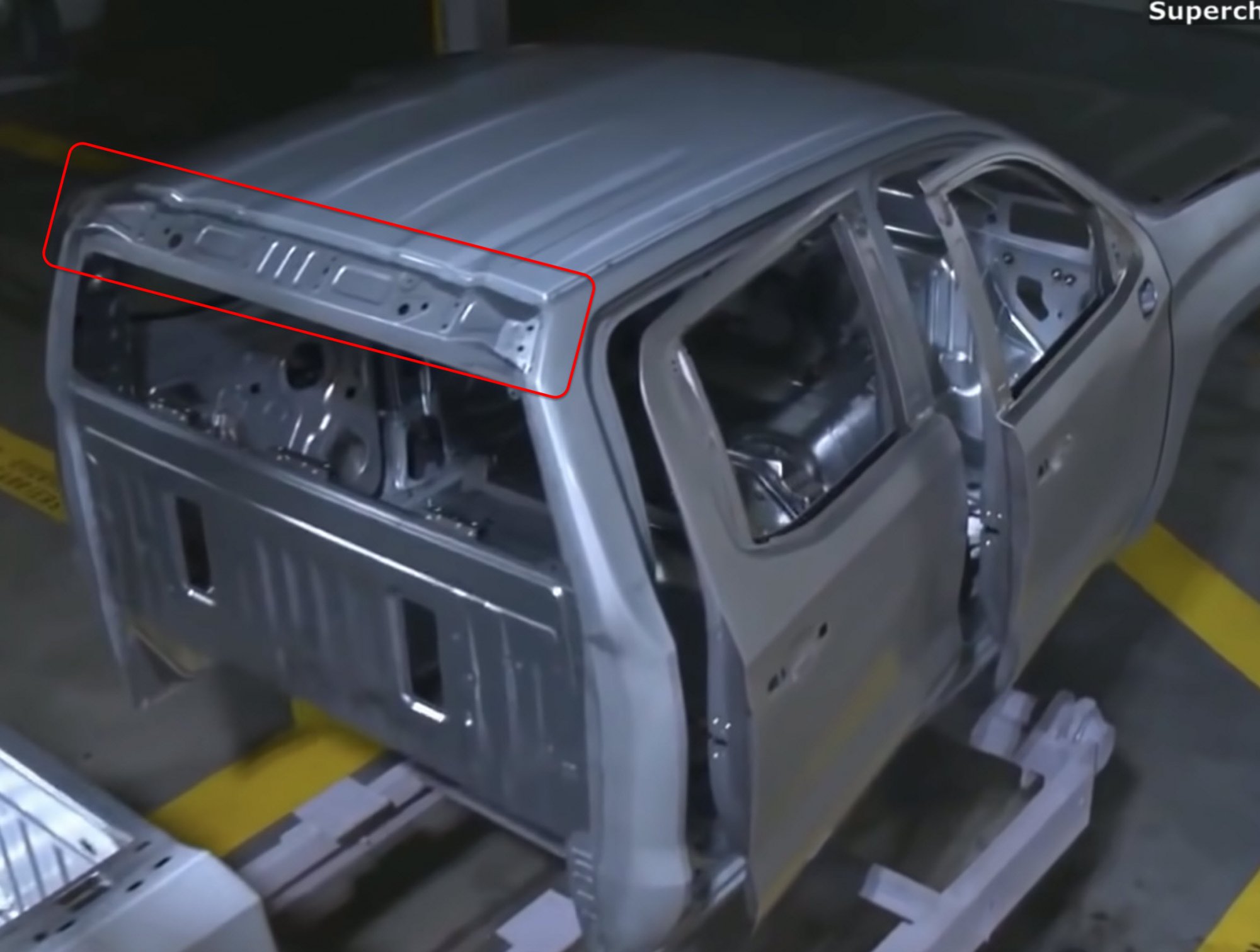

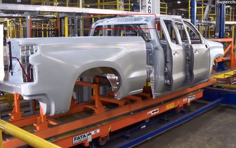

I have been following this thread for ~ 1 month.  I own a 2010 Sierra Denali, and was just about to pull the trigger on a 2019 before the Jan 2 cut off of employee pricing.  I though I should start reading some first.  Glad I did.  My finger is off the trigger for another year.  BUT...I was watching a YouTube video of the 2020 Silverado production line.  I grabbed some screen shots of the body.  I count at least 16 holes of various sizes under that new rear spoiler.
That wind driven rain at highway speeds could be getting under that spoiler and dripping down one or more of the various poorly sealed holes under it.
