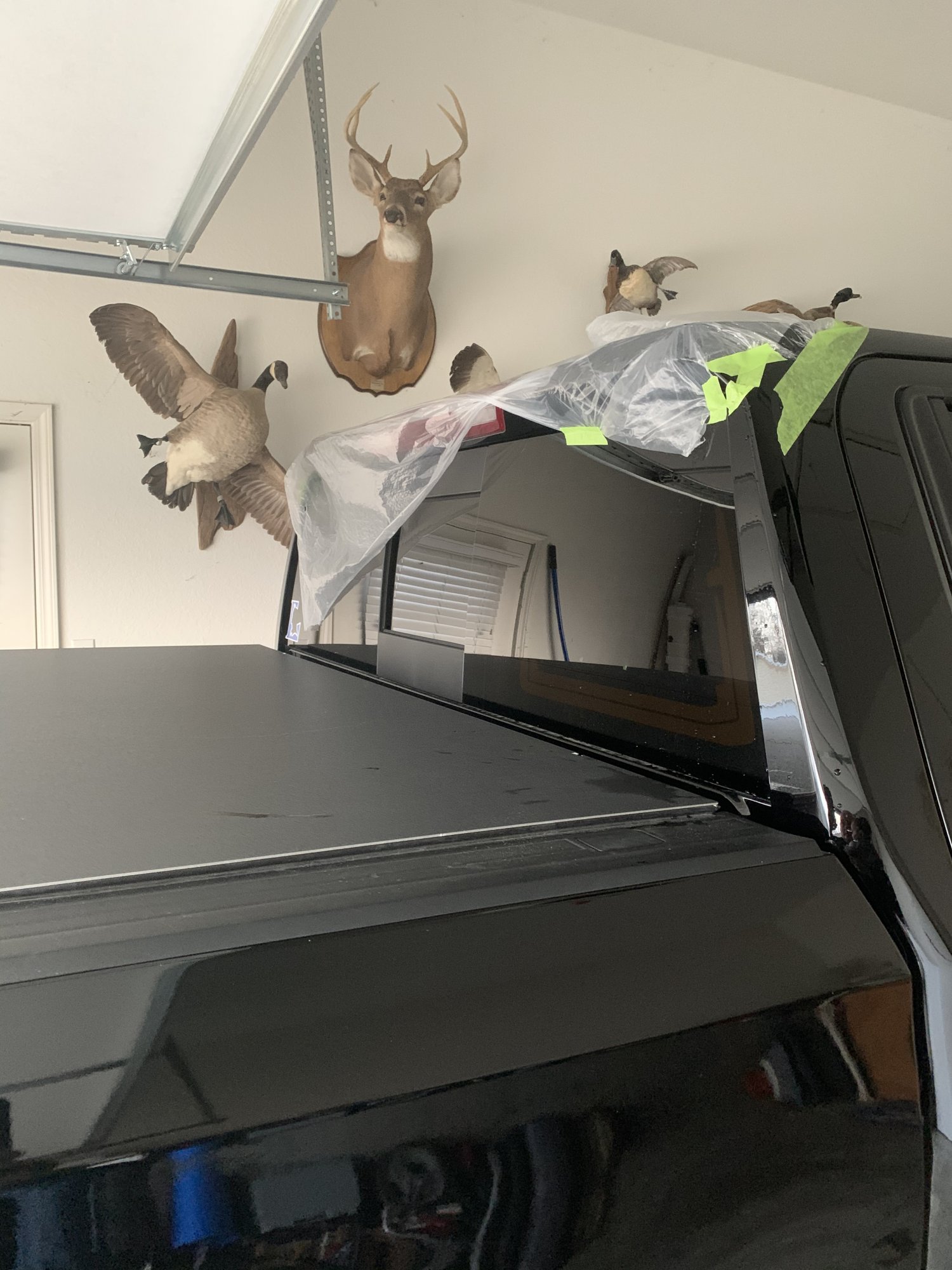

This might not be of any help but here is my window. Haven't had any water inside the cabin during big rain or car washes.  11/19

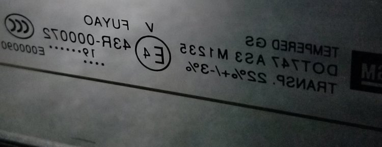

fuyao 43-000072 winDow.  Fairly certain that’s what was on my last one.
