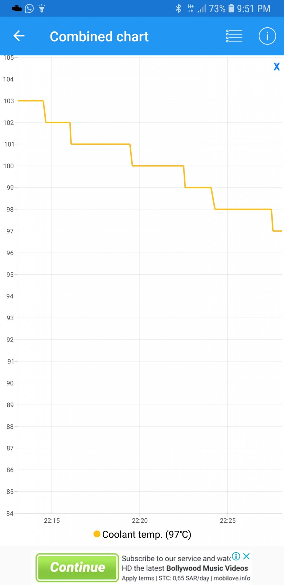

The fans are blowing in the right direction (towards the engine). I didn't think of the temp gun before, but I'll keep it in mind if all else failed.
How will checking the oil pressure switch help? I'm not really knowledgeable in this area.
The heater core was bypassed, and the radiator and the coolant were taken out and cleaned again, but to no avail.
The temps are within the safe limits indeed, but the problem is that they make my fans run all the times, and run on high even on the highway, and the faster I go the hotter the temps get.
In the previous post I attached a video and said what's happening with the truck now. I'm actually beginning to think that the head gasket is "starting" to go out, that's why I ordered a combustion gases tester that's arriving tomorrow.

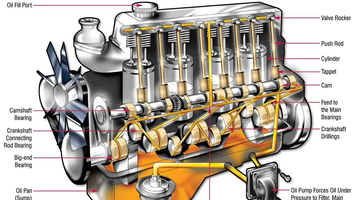

If your engine has oil flow/pressure issues, it will cause the engine to run hotter. The oil has several jobs to do. One is to lubricate, one is to remove debris, another job is to transfer heat away from "hot" areas of the engine. The faster you go, the more heat is generated, and your oil temp will rise. If you were to drive an engine with no oil, the primary cause of failure would be heat related.
   I have seen engines with mysterious, unexplained overheating issues before. On more than one engine with this issue, The crank bearing ultimately failed. I tend to doubt that the issues were unrelated. When is the last time the oil and oil filter were changed? Is the oil level full on the dip stick?
Clogged oil pump pickup screen?
Oil pickup tube O-ring problem?
Oil filter in bypass mode?
Poor oil pump performance?
Poor oil integrity?
You could even try an engine oil flush, but if the pickup screen is already partially clogged, then the flush might help or could even make the problem worse.
No guarantees that you have any oil related issues, but I think its a possibility.

Wouldn't the oil pressure drop if I had an oil pump related problem? I'm sure that my oil pump is working just fine because the gauge (I know, not very reliable) moves in it's proper range. And I did change the oil and filter two days ago, which looked fine to me.

Oil and filter were changed two days ago. 6qt of 5W30 fully synthetic. Heck, even the old oil seemed to still have some life. I never neglect oil and filter changes.
Oil pressure seems fine to me. Increases with acceleration, decreases with idling.
Head gasket leaks were checked with a combustion gases tester. It turned out negative.
I wouldn't really want to try a motor flush, but I'm thinking about Seafoam. It helped BIG TIME in my '04 LS1 GTO.

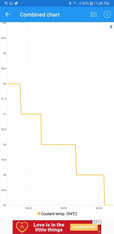

The problem is, it runs perfectly fine inside the city and while idling. The only problem I have right now is the fans coming on high while driving +50mph. And they don't turn off AT ALL. And reading the temp with an OBD adapter, it seems that the faster I'm going the hotter it gets. I don't think the truck should run hot enough on the highway to turn the fans on high.
Everything else is fine until I get on the highway or just high speeds in general, in which the fans never want to turn off.
