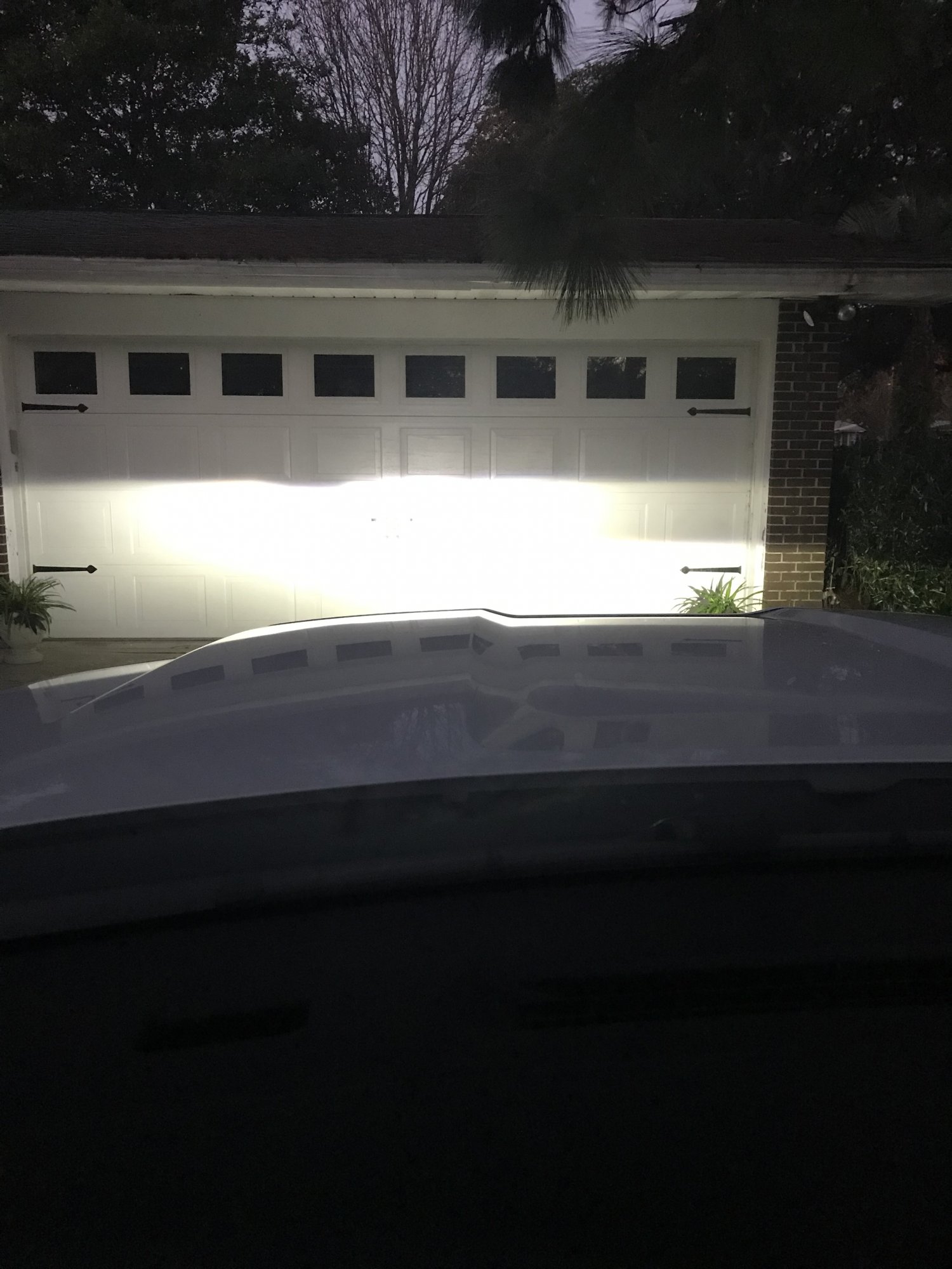

Here is a shot of mine BEFORE the right one was changed. The line is clearly there, the right headlight adjuster gear was broken and was pointing as far down as the light would go. Once changed, they adjusted using the left one for reference. They felt comfortable doing this because the visit before they had it in their adjustment bay with lines painted on the wall. My driveway is slightly slanted downwards so the lights point higher in this pic than on the road. This is low beam.

I know that with my 2018 (with LED projectors), off the lot, I got flashed some (not much); but even more, I noticed that my high beams were lighting way too high in the air and not getting down the road enough. I lowered both sides, and the result are I never get flashed, get more light 30-50 yards out in low beams, and have much better down the road throw on high beams.
So getting flashed might be a good indicator you are wasting light into the air where it does no good.
