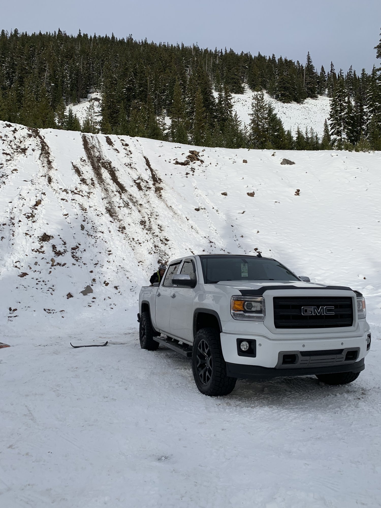

Never have towed with it
and yes I did the cylinder deactivate on it after reading up on lifters going on the first time .
I’m running a leveling kit on 33s same stock rims
oil changes done every 2500-3k miles . Full synthetic
i baby this truck !

You have a really nice looking truck. Keep it for now and pay it off. You have 24 months of warranty to decide what you want to do. You could also consider an extended warranty if you decide to keep it. Several threads on how to get the best deal on the warranty.
