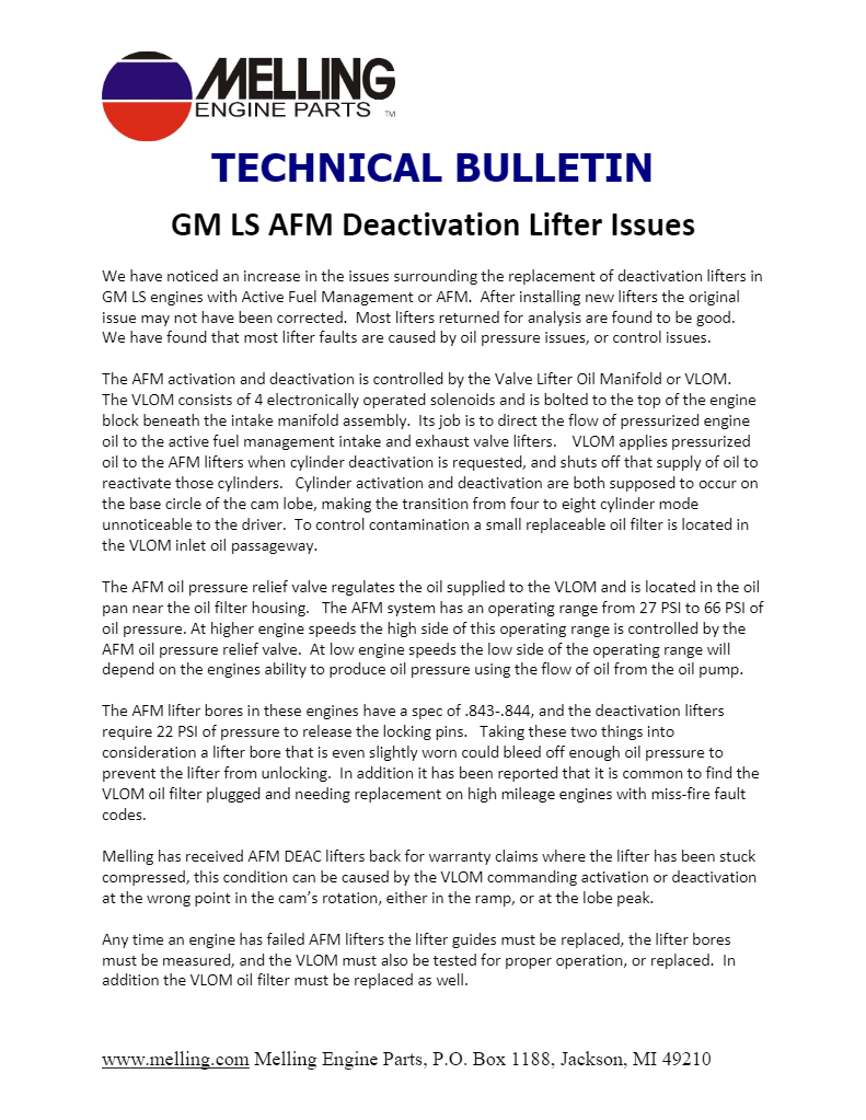

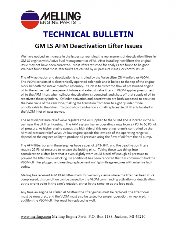

3 minutes ago, O Town Denali said:
This is a good article by the lifter maker:
It probably has been posted before, so my apologies if it is a repeat.
Melling-tech-bulletin-on-GM-LS-Deactivat
I don't see an article, not being a jerk, just don't think the link came through.
So if one or more lifter bore(s) is/are “out of spec”  then what? block replacement? I’m assuming you can’t sleeve a lifter hole... who pays for that? because who’s fault is it it’s out of spec?
