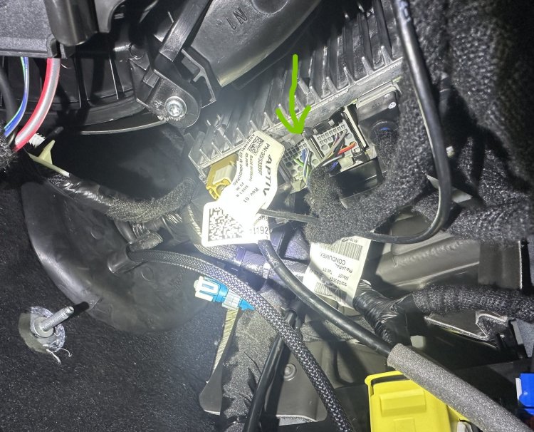

How hard or what technique did you use to get the plug out? I hate to pull on the wires but there's not much real estate to pull on otherwise. It looks like everyone has broken part of plug trying to get it out. Thanks in advance for your help.
Ok so I have everything up and running since my last post, but I have a minor problem. I have the amp installed with no remote power. The amp has an auto sensing option for powering on. Ive used this just fine on other amps in other vehicles. Some time but not always when I come up to a red light and the engine shuts down the amp turns off too then right back on when the engine fires back up.
Any suggestions on where I can easily run my remote power wire to.
BirdDog
Its a real pain to get them out. There is a little tabs you need to pull down on first and be careful because I did brake it. Then you have a little lever to push down on and it should come out.
There is a fuse in the passenger fuse box that has a blade tap for this exact thing.  Look in the fuse box on the front passenger side and there will be one in there for standby power.  It is open already, no need to splice or jam something in anywhere.  Just put a blade on your blue remote wire and plug it in.  Works fine with auto stop start and everything.  This is where I am tapped in at.
