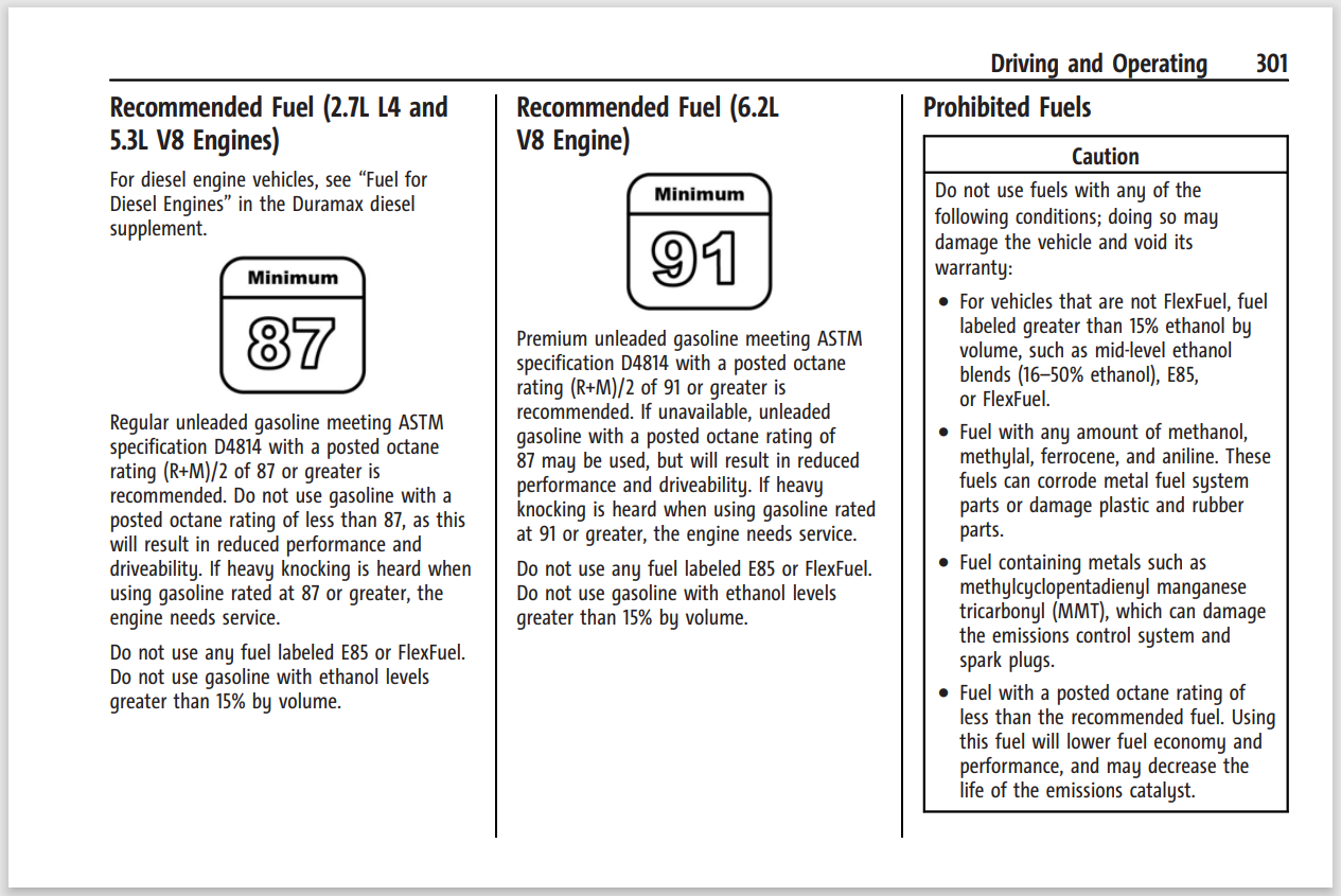

GM is still spec'ing 87 octane for the 2.7T HO.  However, your MPG results point to the fact that a boosted DI engine loves the higher octanes and can benefit from it somewhat.
Ford has even proven this with its EcoBoost engines.  They all run 87 all day long (except the 3.5 HO), but MPG (and obviously performance) gains are noted on premium.

Going off of Customboss's report that I had quoted to, his 2022 is an LTD, so the non HO engine.  His initial data seems to possibly support this benefit, but obviously as he mentions, more data will help.  Expenses come to play here as well as 91/93 octane is roughly $0.70-$1.00 more/gal than 87.
HO or non HO, its impressive of GM to obtain and only require 87 octane.

Lower elevations, 87 octane or higher. May make a difference.
Higher elevations 85 octane works.
Having lived in Colorado over 30 years and having tried higher octane fuels in many motors I believe there is no advantage. Just costs more.
If higher elevations needed higher octane we would have it. Scientists and engineers are smarter than most.

I agree with you  on naturally aspirated computer controlled  DI engines.
The Trail Boss is Turbo charged so if you have a lead foot or tow you are gonna need more octane.  That turbo can pump 22 PSI boost on the 2.7L.
I proved that running 85 octane here works fine but its retarding the timing significantly if I thump it.
87-88 seems a sweet spot for the L3B regardless of altitude.
Watch the engineering video in this thread that CAM shared. The lower octane allowance for higher elevations is from 1940's data.  The states regulate that not the feds so its state by state and not proper data for modern engines.
