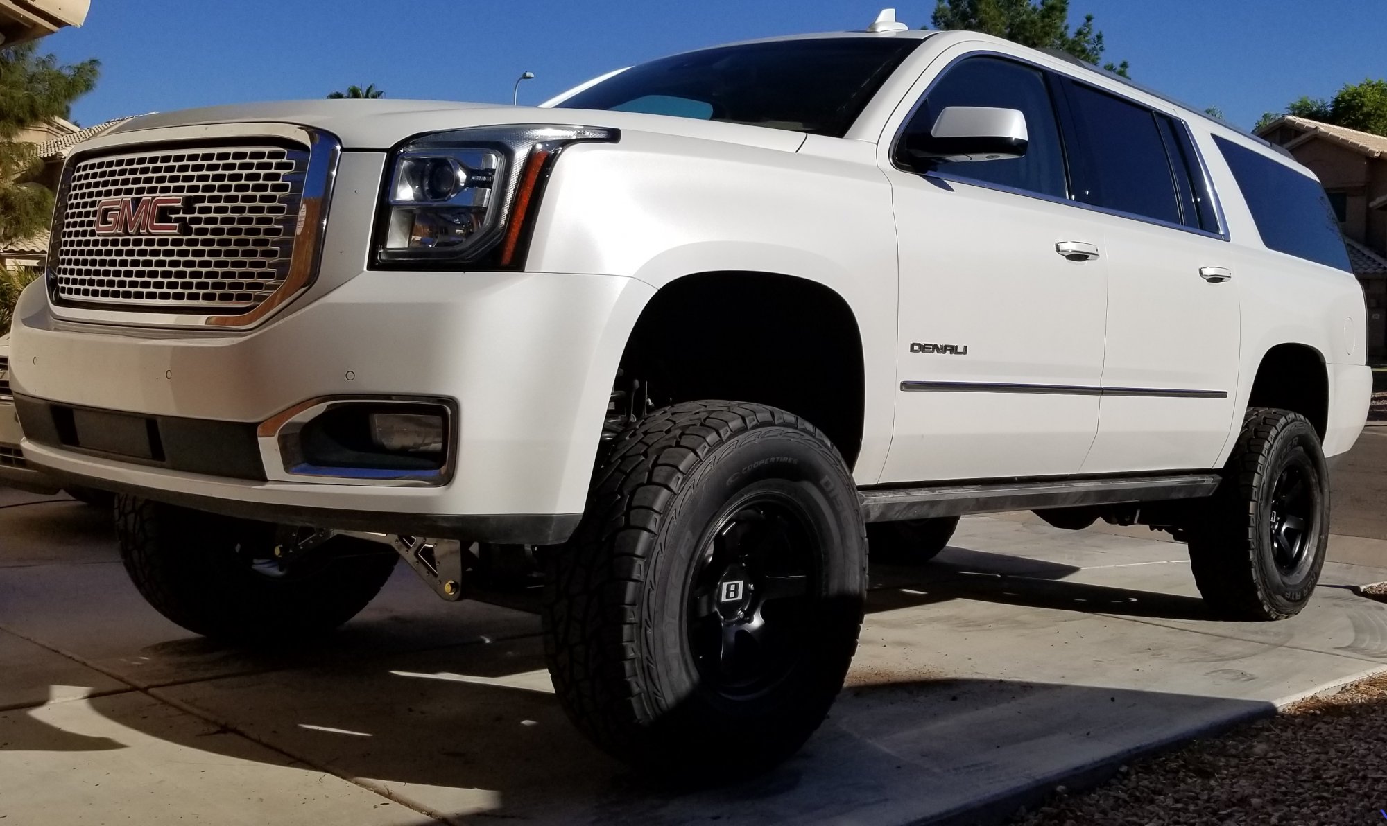

Thank you for your constructive criticism.  Very helpful input.  Unfortunately, you are incorrect.  Everything does work perfectly with the exception of the speedo not stating the correct MPH.  I can use "Kentucky Windage" of +5MPH to be accurate (as long as I can have one hand free to use fingers) or I can simply look at the Waze MPH on the GPS which is more accurate. The Magnetic ride front suspension works great!  The rear auto leveling air works great!  Zero issues.
I need the lift and additional clearance because I actually use my vehicle in areas that require it.  We crossed a river 8 times this weekend with 35 inch tires under water.  I use 4WD at least 2-3 times per week.  If I'm going to spend $86k on a vehicle, I can assure you it will do what I want.  Not "I will do what it wants".  I've got nearly 30k miles on this lift setup so far.  Pulling heavy enclosed trailers, off roading and highway driving.  My tires look barely worn, gets great mileage still and will hurt peoples feelings red light to red light.

Wow, pretty harsh, considering you have no idea what you are talking about, at least in my state, where a 7" lift is perfectly legal.
My truck still runs and drives just like stock, thanks to a very high quality lift kit that retains the stock magnetic shocks in the front and air shocks in the back.  By using the correct offset wheels, the 35" tires I chose to use have no rubbing issues at all, and the turning radius has not changed either.
