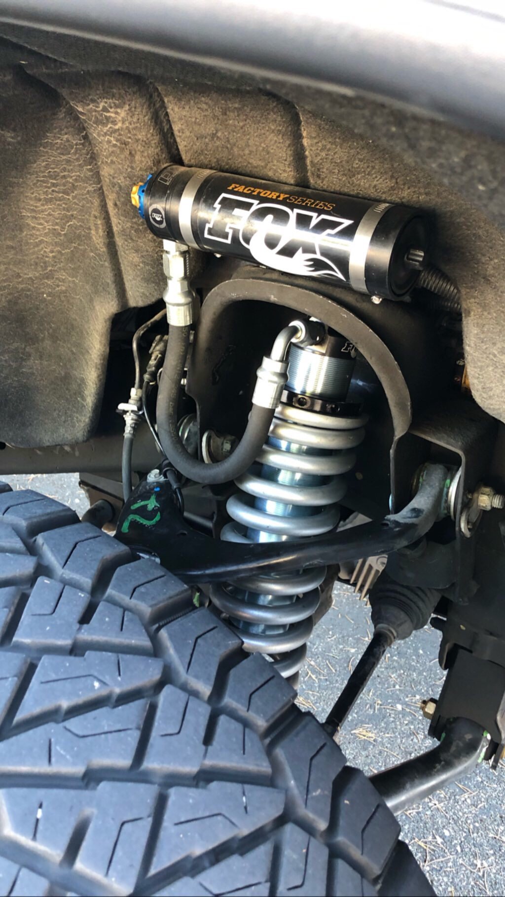

I have the BDS with Fox coilover 2.5 DSC. I love them and the ride is fantastic. If you got the funds, go for it. I also got the BDS rear leaf springs. Cost me 1,000 for install and had to get an alignment.

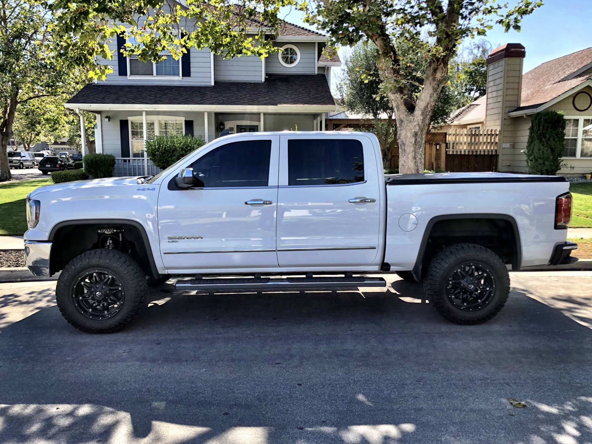

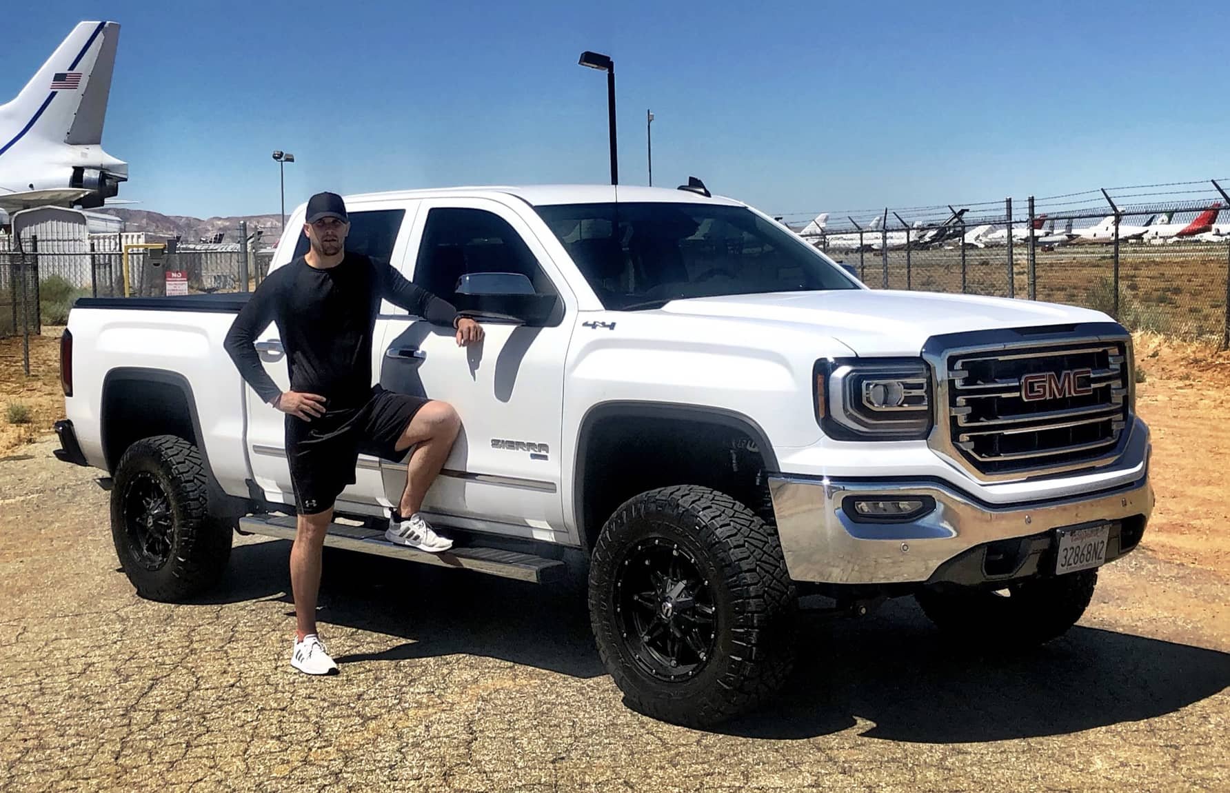

I run 18x9 fuel wheels +1 offset. Tires are Ridge grappler 275/70/18. Zero rub and no trimming. I ran that on a 2 inch level as well with no rub.
My Fox DSC settings are set at 5/10 for low speed compression and 5/12 for high speed.
