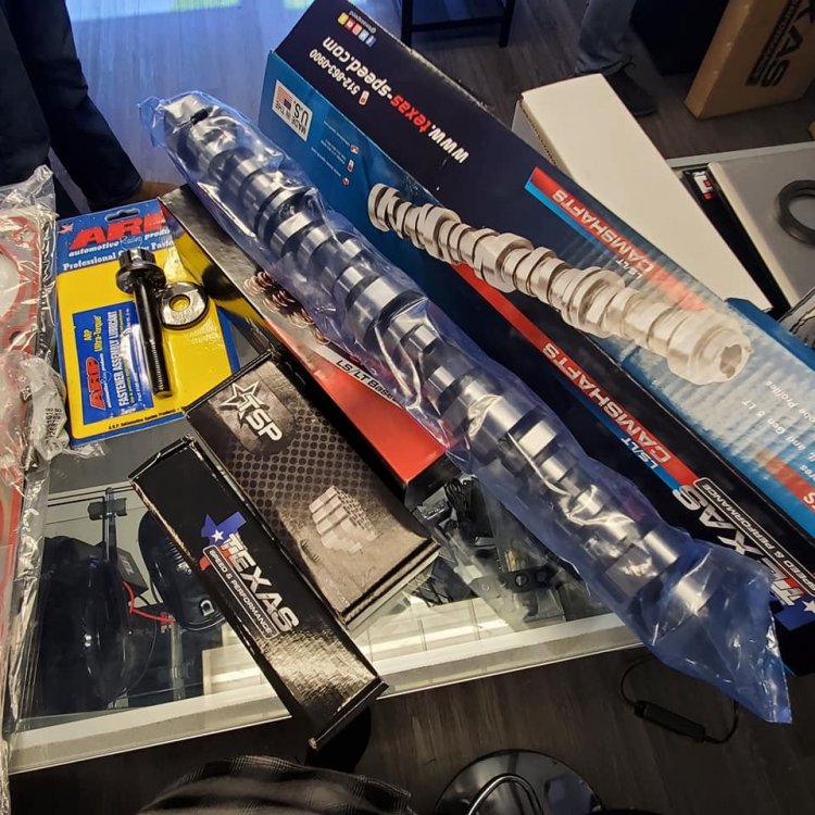

Earlier this past week I received my stage 3 cam kit from Texas Speed, and long tube headers w/ catless Y pipe from Kooks, and sent my ECM out to HP Tuners for unlock. This thread will be a mini build thread of the process, and the results later this week after tuning is complete!
Part List:
- TSP L83TR-3 Camshaft [222/230, .635"/.635", 112 LSA, 32% fuel lobe]
- TSP .660" Dual Valve Spring Kit
- TSP DOD plug kit
- New Pushrods
- LS7 Lifters & new trays
- Phaser lockout kit [required modification, TSP will be working on a new one based off of our measurements]
- ARP bolts
- Kooks Long Tubes 1 7/8ths" w/ cat-less race Y-pipe [3" to 3 1/2" collector]
- HP Tuners ECM unlock & Custom tune

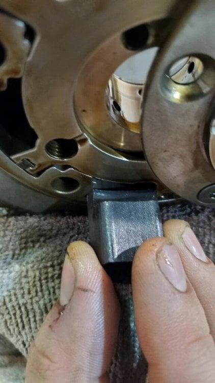

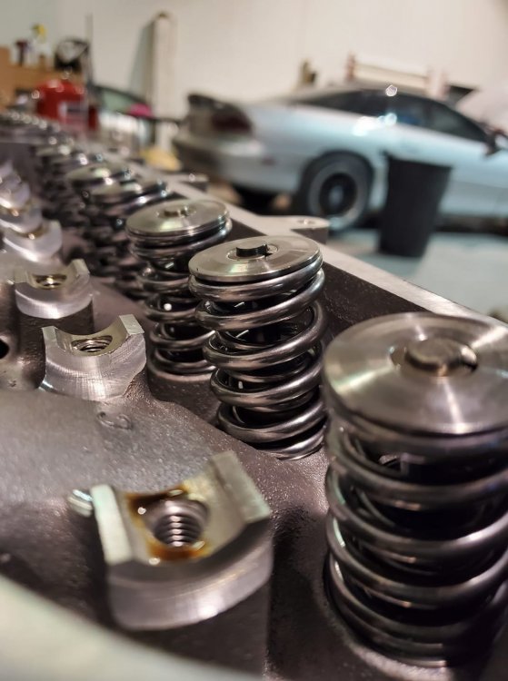

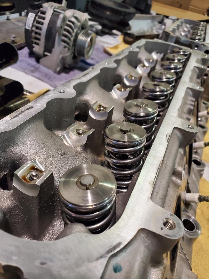

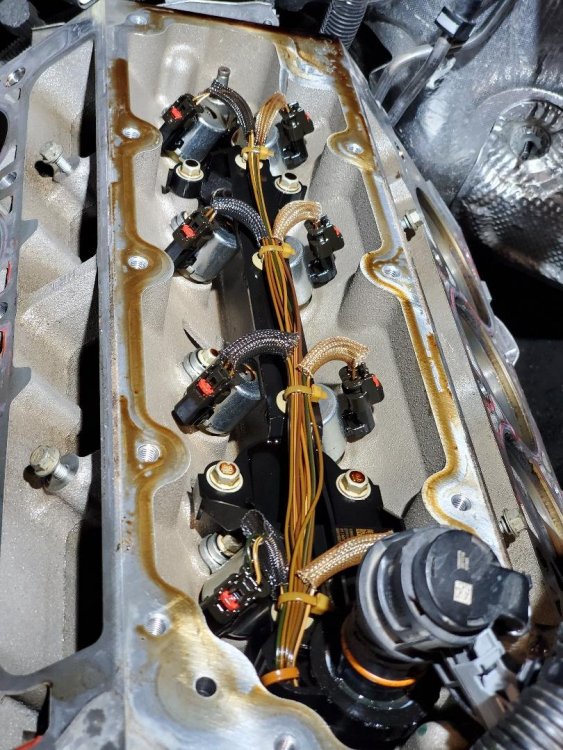

So far, as expected, the block is still the same LT1/L86 as previous generation, however the new 6.2L L87 has a completely different Cam phaser, and the DOD delete plugs are held in by the OEM screws vs. rivet style. My truck currently has 19,XXX miles on it, and is looking to be in pretty good shape for the amount of on and off road abuse that I've subjected it to over the past year. As for the cam choice, yes it is a 5.3L cam, however I have no plans on swapping out the torque converter at this time, and I want to see where the limits of the new 10 speed are before I fully push the envelope. It will still offer a size able power bump in the 6.2L as I have the extra displacement, and after talking with Texas Speed, its the cam that we all agreed would be the best bet. To what I know, I'm the first 6.2L to get cammed, and so I have tried my best to document the entire process for anyone else that is looking to do the same with theirs, and as I found out in the process, the new L87s have a brand new cam phaser vs previous models.
So, without further ado, lets get onto some pictures:
  • Replies 33

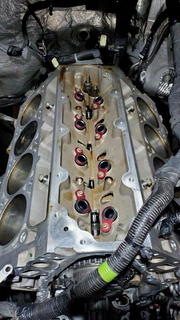

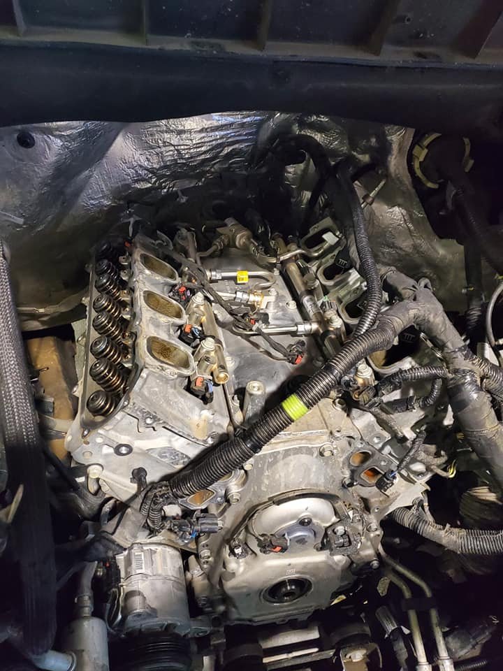

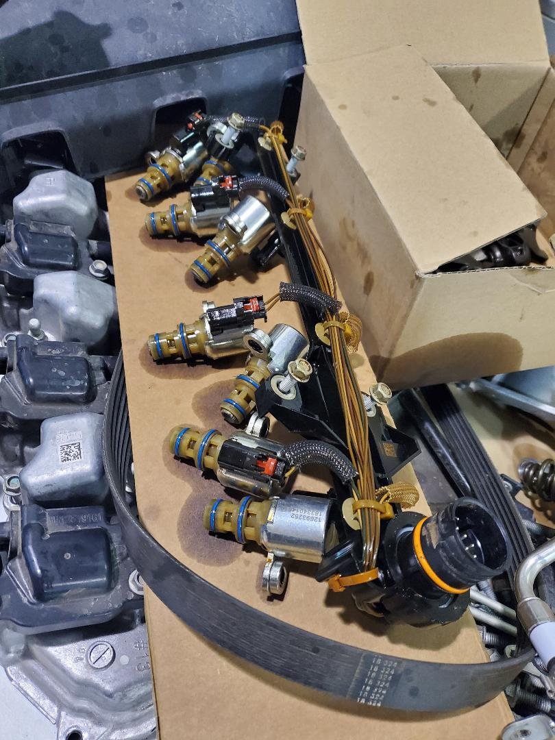

Oem heads & springs, as well as the new dual springs installed, and close up of the new style Cam Phaser, and the delete plug [pre-modification]
