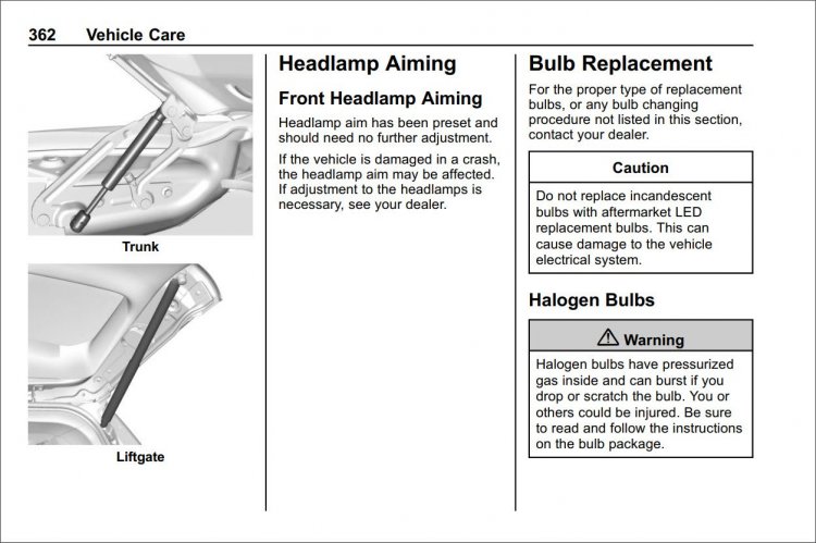

I recently purchased a new 2020 2500HD LT Z71 from the dealer with aftermarket 5” suspension lift and 37” tires. I decided to replace the halogen bulbs with aftermarket LED bulbs that work great, but I blind everyone I pass. I tried calling the dealer to inquire about headlamp adjustment, but they told me to contact the place who lifted the truck. That place said they had never received a call like that and headlight adjustment wasn’t a part of the lift kit. I was inclined to adjust on my own, but it seems the standard headlight adjustment screw doesn’t exist on the 2020 2500HD. Has anyone with left/level been successful at adjusting the headlamps? I got pulled over yesterday and the police officer said he would cite me if I didn’t get them adjusted...

Owners manual says the lights are preset and shouldn’t need adjustment; in the event of an accident to please call the dealer...can you send a link to the other post? I wasn’t able to find...

Thanks everyone! I finally found the screws! Yes, the same screws just like the 19 and older models, only the placement is about 12 inches down, just behind the lamps when you open the hood. Since my truck has the lift, I wasn’t able to get a good look down in there without a ladder, and the dealership was no help - I’m guessing they haven’t had to work on these much yet since they are still relatively new? Once I found it, just a couple of turns clockwise and I was back in business. I did the standard 25’ method for good measure and no more blinding oncoming traffic!
