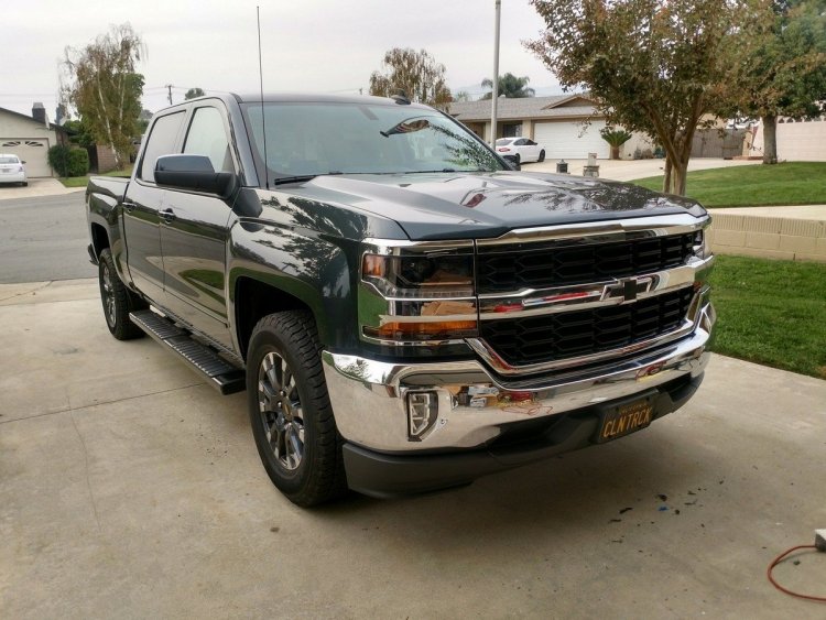

This is my current truck and more likely my last, so I'm enjoying to the fullest.
Her it goes..
It' a 2017 LT Graphite.
Mesh grille black powder coating by Grillcraft
2" front lift to level it. (for those complaining about the pogo stick rear end when going through bumps or whoops, this will fix it.)
Homelink from Mito (programable garage door opener) always on.. I hope no one breaks into my truck and gets in the garage and tries to rob old rusted bicyles, dog food, cat food, I forgot my 2002 Corvette Z06 with 30,000 miles. And my Carbonfiber Trek. ls forgot my pitbull that lives in the garage when we are not home.
Auto dimming rearview mirror from eBay
Auto dimming left side mirror glass with signals, right side mirror glass with signals out of an LTZ from Craigslist and a shifty individual.
Left A pillar assist handle from GM
5  2018 Nissan Titan SD Diesel 18" wheels and off road tires from Bulletproof Suspensions  in Mentone, CA.
1-1/2" hub centric and wheel centric spacers from Four Wheel Parts in Riverside, CA.
Cargo Bed with LED lights GM from eBay
Added 6 round eye load tie downs GM from eBay
Wired a second 5 lead trailer plug hidden behind rear bumper to install 60" brake, turn signal and reverse lights from eBay. (dont buy them from an auto parts store, I bought mine for $21 on eBay)
Black grille bowtie from GM - all other emblems shaved.
2 extra horns same as what the truck came with from eBay.
Chevy center caps shaved off in the back and glued them to the old Nissan  ones. People ask me if they are from the 2020 HD trucks. LOL I had them before GM
I did all the installs, including wiring like GM would put. -  All emblem removal by yours truly.
1. In the works... Katskin leather seating.
2. Replace all the POS speakers, one blown already.
3. Wire my Radar Detector
Questions? PM
Ernie
previously lovecars.com
now lovecars.co
