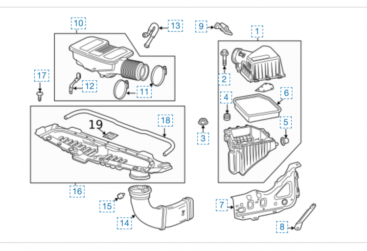

I agree with this as I don't think were hearing the whole story here. The intake entry point is located on top of the plastic cover (cant remember the name of the cover) between the underside of the hood and inside the grill now you would have the ingest a whole hell of a lot of water to get to the entry point of the intake to the motor and total saturate the air cleaner with water that it couldn't absorb anymore then get sucked into the motor. The air cleaner is made of thick paper material and will act like a sponge trapping water to a point unless totally saturated and it would take a lot. Sorry but I don't believe this story at all.
I have mud run a lot many years ago with open air cleaner elements that sit on top of the carb puddles so deep that the motor was covered with mud and water and only once did I hit a deep water hole and staled the motor due to the open air cleaner getting soaking wet with water and it never made it past the air cleaner and into the carb it just clogged the filter, this is with a 750 Holly 4 barrel and they suck a lot of air with the secondary's open.
Edited by Silverado4x4
I wonder if the intake air tube is not properly attached to the air box. If that hole in the bottom of the air box is wide open I could see a lot of water entering the air box.
Jay
Where would that be located?  The truck is still at the dealer but im trying to find any flaws... Can't believe this at all
