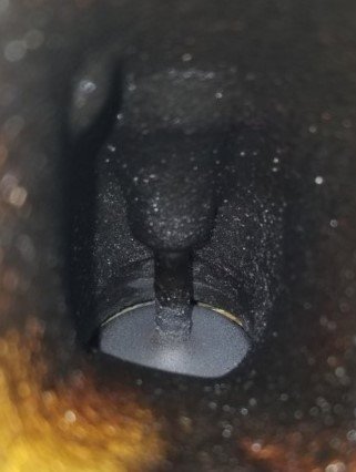

If the engine ran long enough moisture is not a concern to have. I have 109,000 miles on my DI 5.3 engine, I took pictures of my valves at 104,000 miles and have zero concerns with them at that mileage. There is a thread on it I made.

This is Cameron's motor mentioned above at 104K miles. GDI isn't an automatic death sentence.
