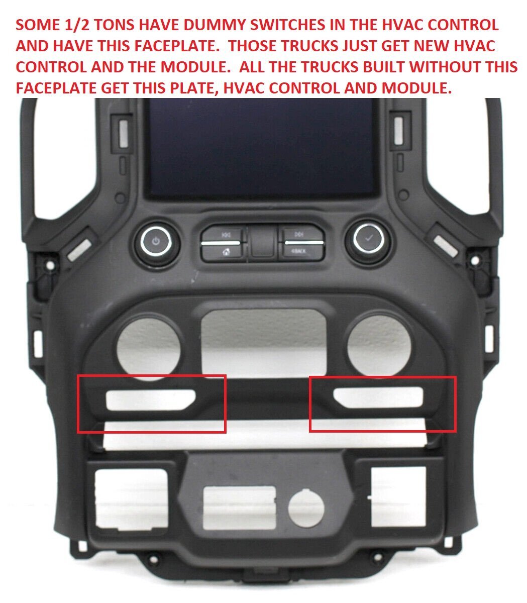

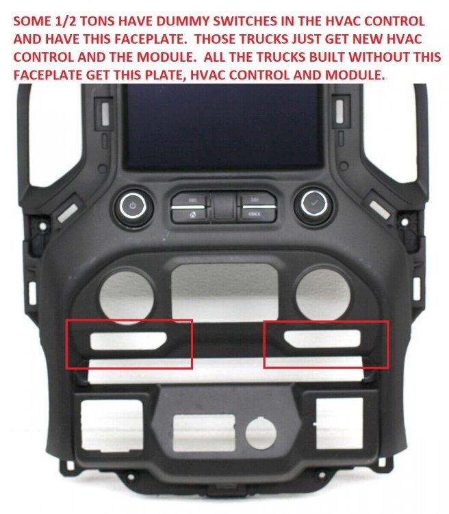

6 hours ago, kylant said:
why would you need a new screen?
mine have buttons on the center stack and there is an icon on the screen. the icon is surly in the software
The faceplate.  That radio faceplate that the screen, HVAC controls, etc. attach to is why.  GM doesn't sell just the faceplate.  They only sell the radio screen/faceplate assembly and only through GM approved Electronic Service Centers and not GM directly.
All HD and some 1500s that are missing heated seats were built with non heated seat radio faceplates and don't have the holes present for the seat control switches.
See below:
