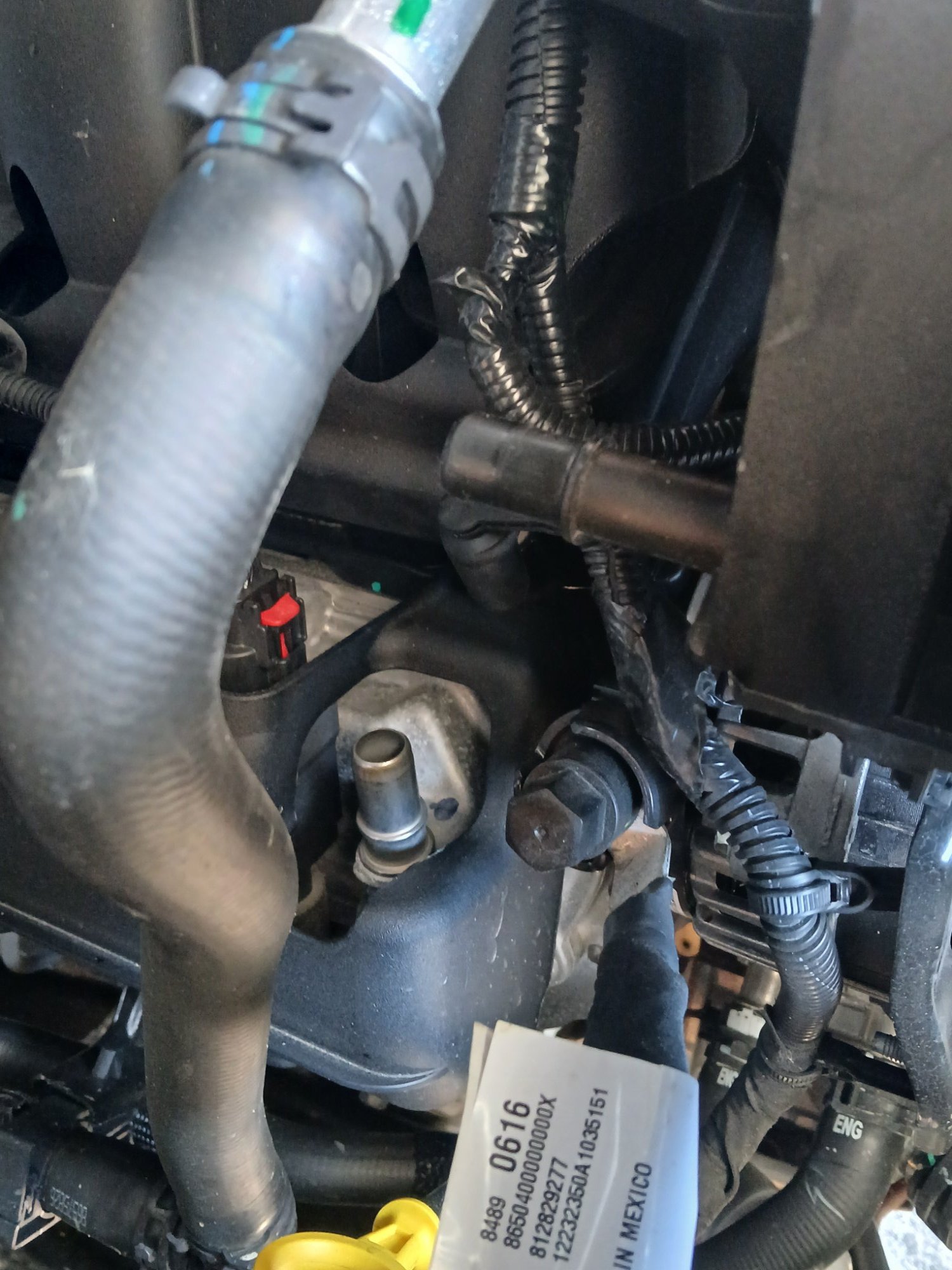

For the OP. I can give a lot of info on putting a catch can on a L8T/6.6 gasser if you want to PM me i have pics.
Is it needed, absolutely not, does it do something yes. Mostly, when its cold, it sucks moisture out of the oil before it would get burnt off anyway. Warmer weather it doesnt catch much, but some moisture.
    There was information i stumbled across wile researching catch cans for the motor that explained whats going on in the valve covers that it isnt needed.
Hear is a couple pics of the ( intake tube ) side that goes between the passangers side valve cover and the air intake box. Its easy to remove the tube. I did, tube was spotless as well as the connecting spots, note the clean Q tip swabs i swabbed the tube and connection points. So seems no oil or vapor is/was getting into the intake.
   I installed the can one day before the first oil change at about 5,400 miles.
