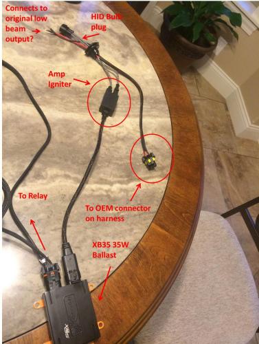

I ordered the Morimoto Silverado spec HID kit from TRS with 35W ballasts and the 5500k H11B bulbs. I opened the package and started going through the components in the box. I was aware that some of the components would be different from the other Morimoto HID kits that other's had used previously on their silverado's by reading through page 67 of this forum and comparing what I saw to the instructions on this TRS link:
http://www.theretrofitsource.com/diy-installation-guides/guide-hid-bulbs-xb35-h-series.html
Up to page 67 I don't recall if anyone used the Morimoto Silverado Spec kit. in the attached picture you will see that this kit has amp igniters, not sure if other kits had those. From the link I see that the amp igniters plug into the ballasts and plug into the HID bulbs.
I have a couple questions and am hoping some of you can help. In the picture that I have attached you will see that the grommet has 2 sets of wires going through it: the HID bulb adapter (black and white wires) and wires that connect to the original low beam output (red and black). The red and black wires that go inside the low beam housing have these flat pin-like surfaces, no adapter. How do you connect those to the stock low beam adapter in the housing?
Also, the other end of the red/black wires has a male adapter that I believe plugs into a female adapter that comes from the relay harness (called the OEM on harness in pic). The other grommet also has 2 sets of wires, including the red and black wire that plugs into the stock low beam adapter in housing. What do I do with this 2nd low beam adapter wire in the other grommet? The relay harness only has 1 wire with a female adapter that I think only has to connect to 1 of 2 low beam adapters. Do I just cut it out of the grommet since it wont be used?
Edited by oromero830
This is a follow-up to my previous post. I figured out that the flat pins can connect into the stock low beam adapter and I put some electrical tape around them on the passenger side. I also figured out that I don't need the red/black wire oem adapter on the driver side grommet so I removed it. The passenger side stock low beam adapter is plugged into the output that comes from the relay harness, and it has a capacitor link and a ground.
I got everything all wired up and I had some buzzing coming from the ballast that's connected to the driver side bulb. I made sure that my negative ground is grounded to bare metal as was suggested in previous posts. I removed the black paint from the washer, screw, and 45 degree brace. I swapped the ballasts and it was still buzzing. At first the buzzing is loud and it gets quieter but not completely as the bulbs warm up. I read Wendysorbust's post 1748 about his relay being fried. I decided to check that to make sure even though it's a brand new kit. Everything looked normal. When I plugged both relays back in, both ballasts are now buzzing. I've tried unplugging and plugging the relays several times and the blasts are still buzzing. I've double checked all connections. I'm going to call TRS tomorrow. Does anyone have any other ideas?
