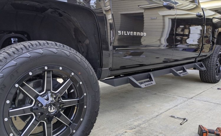

got the Magnum Steps installed, took about 3 hours by myself, 50 bolts, 100 washers lol but I like the finished product
