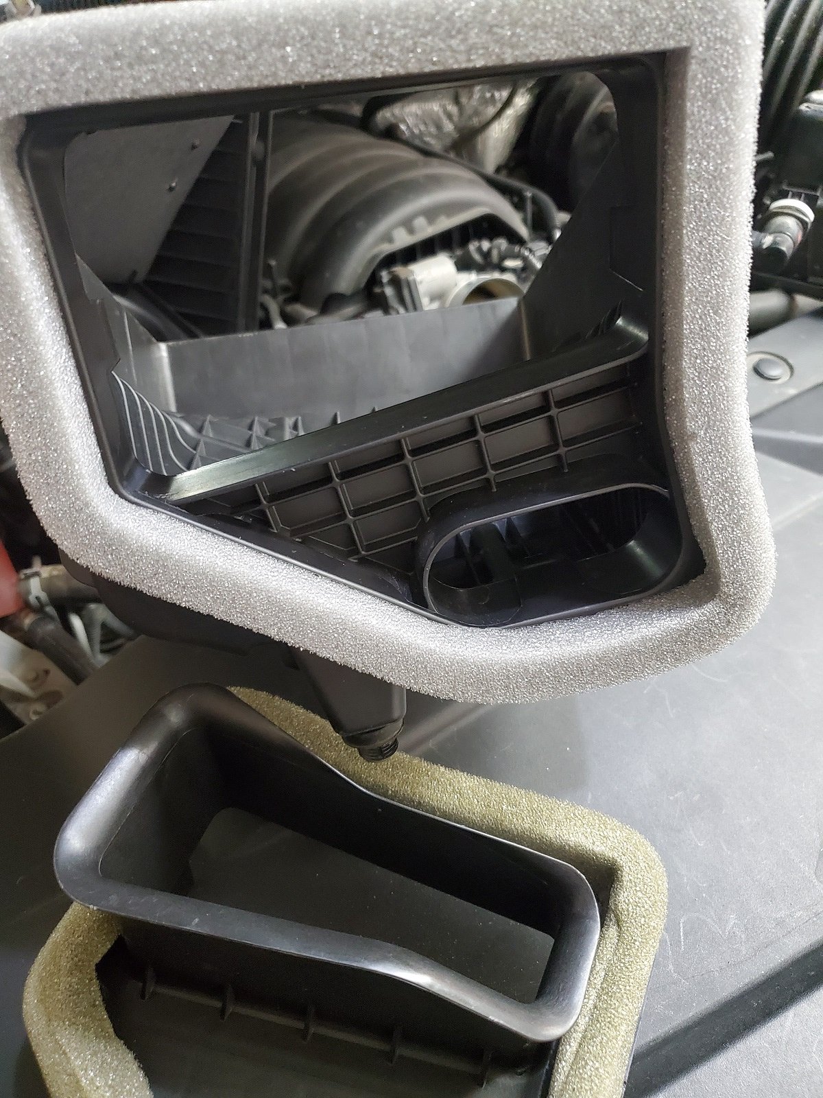

Air box seal from a 6.0. MAP is reading 5kpa low at wot so I'm removing potential restrictions, starting with the seal. I came across a thread where the op did this on a 5.3 with a 6.2 air intake/manifold and it worked for him. I still have to get some data, Fingers X

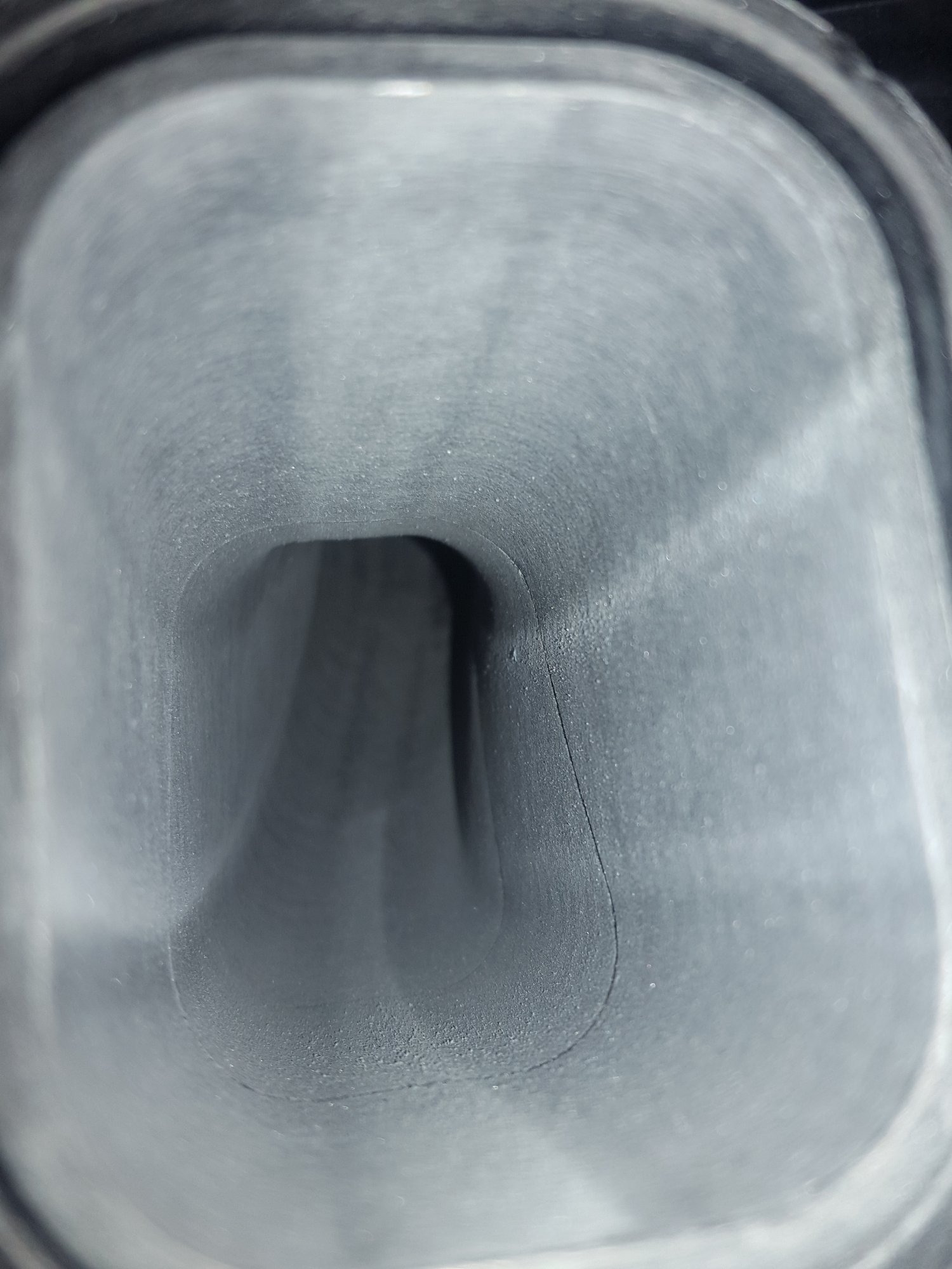

Decided to try my hand at porting. I still have to finish the other bank, open up the inlet for an lt5 tb, and clean it up. I'm going to correct port sizing with epoxy (phenol based). All the ports were .02 large in height, width they were all undersized. Might open up the seam's at the flash traps a little bit and epoxy them as well. I should point out that this didn't happen over night, lol. A lot of screw ups (manifolds) until I figured out how to get it the way it looks now. It's more of a project then pursuit of horsepower. More or less porting is just shifting the power band anyways.
