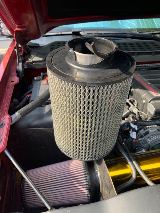

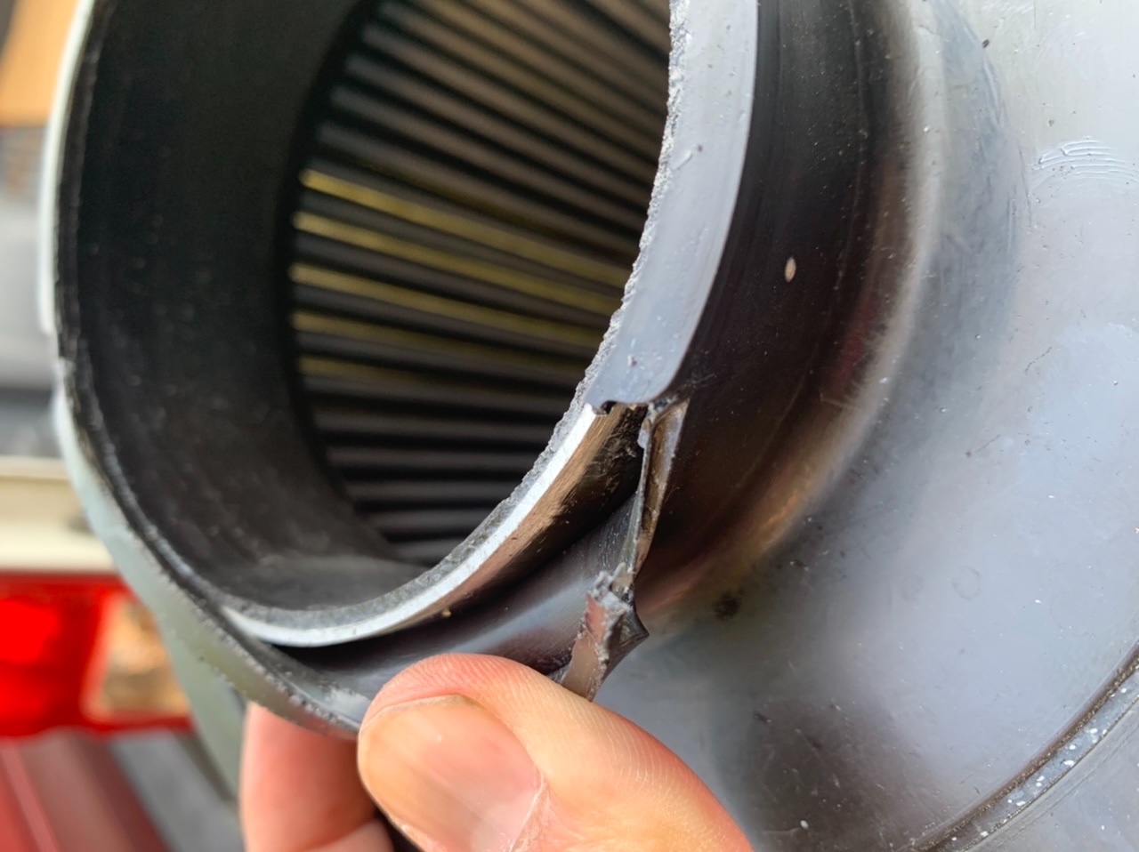

Another aFe Filter torn at the inlet. But their customer service is top notch and already got another one on the way. Throwing my backup K&N on for now.

Rubber or plastic?

It’s rubber with a metal band inside. The metal band clamp onto the tube and as overtime the rubber pretty much bond onto the tube and won’t let go. Sooooo the only way to get the filter off is to rip it off. I spent over an hour try to get it off without ripping butttttt no luck.

A light smear of Vaseline 😉
