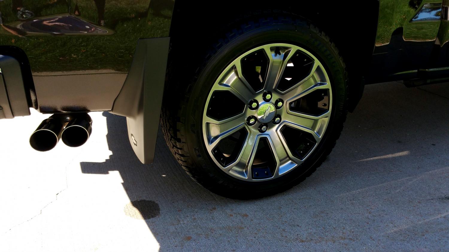

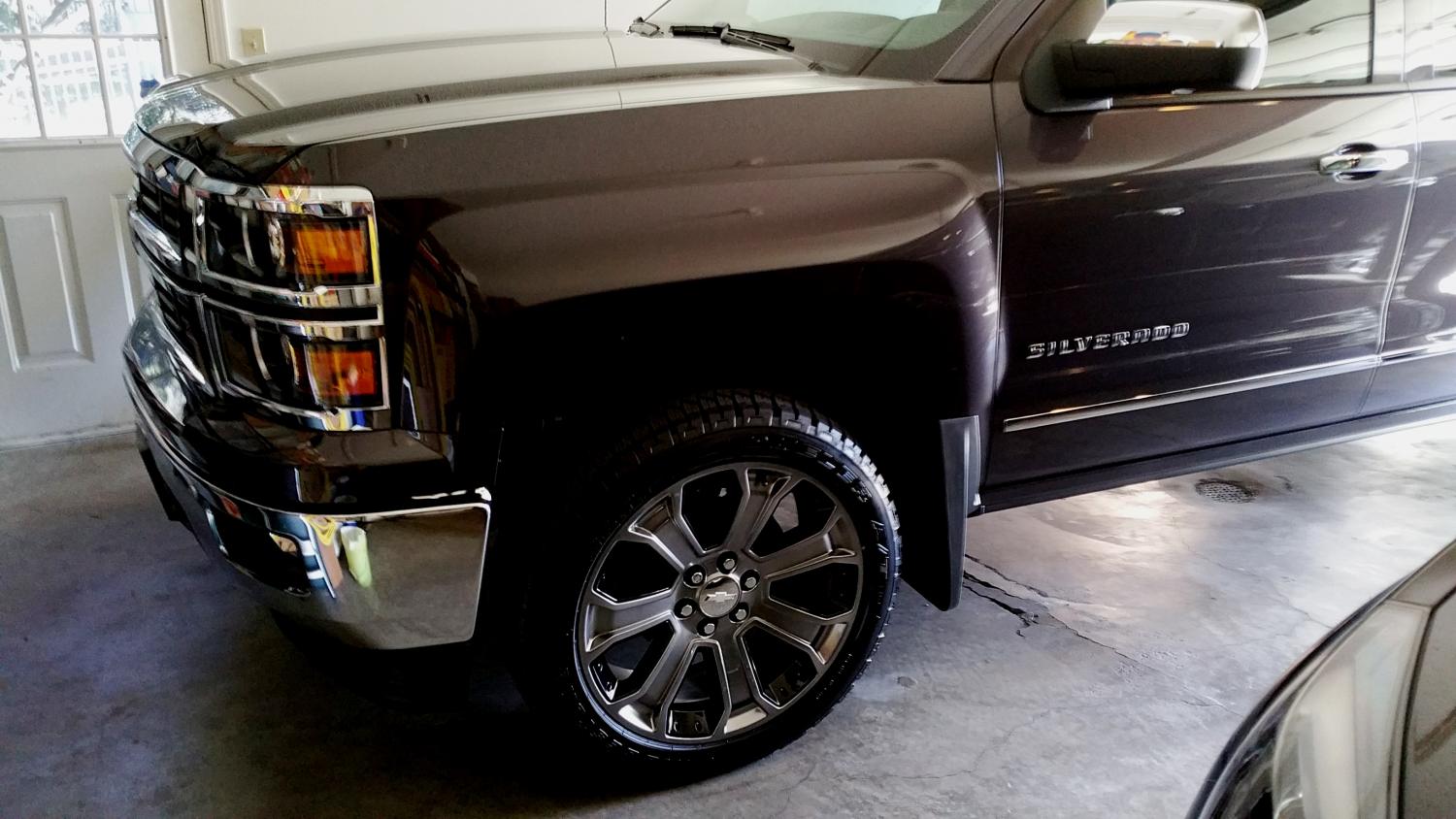

Put on the "winter" wheels/tires today... GM accessory wheels 22" CK164. Bridgestone Dueler RH-S 285/45/22.
