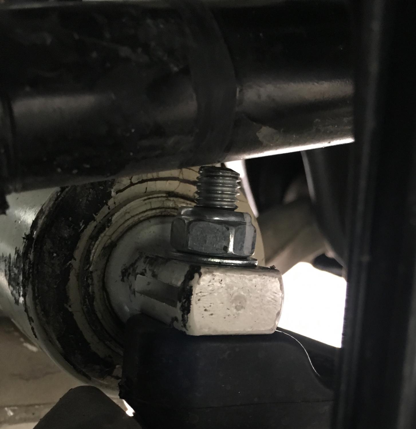

So I just added a 2.5 Rough country level w/ blocks on some 285/75/18 Toyo ATs on my stock wheels.
I noticed some rubbing that is from one of the lower shock bolts. Anyone else encounter this problem?

I've read that some people just put the bolts the other way so they have the head of the bolt where the nut it.

Agreed. This is exactly what I did on my RC level before I swapped it out for the Bilsteins. Just flip the bolts over. Plenty of room.

Yeah the motofab level has you put the bolt on top nut on bottom. Not sure why you would ever do it the other way.
