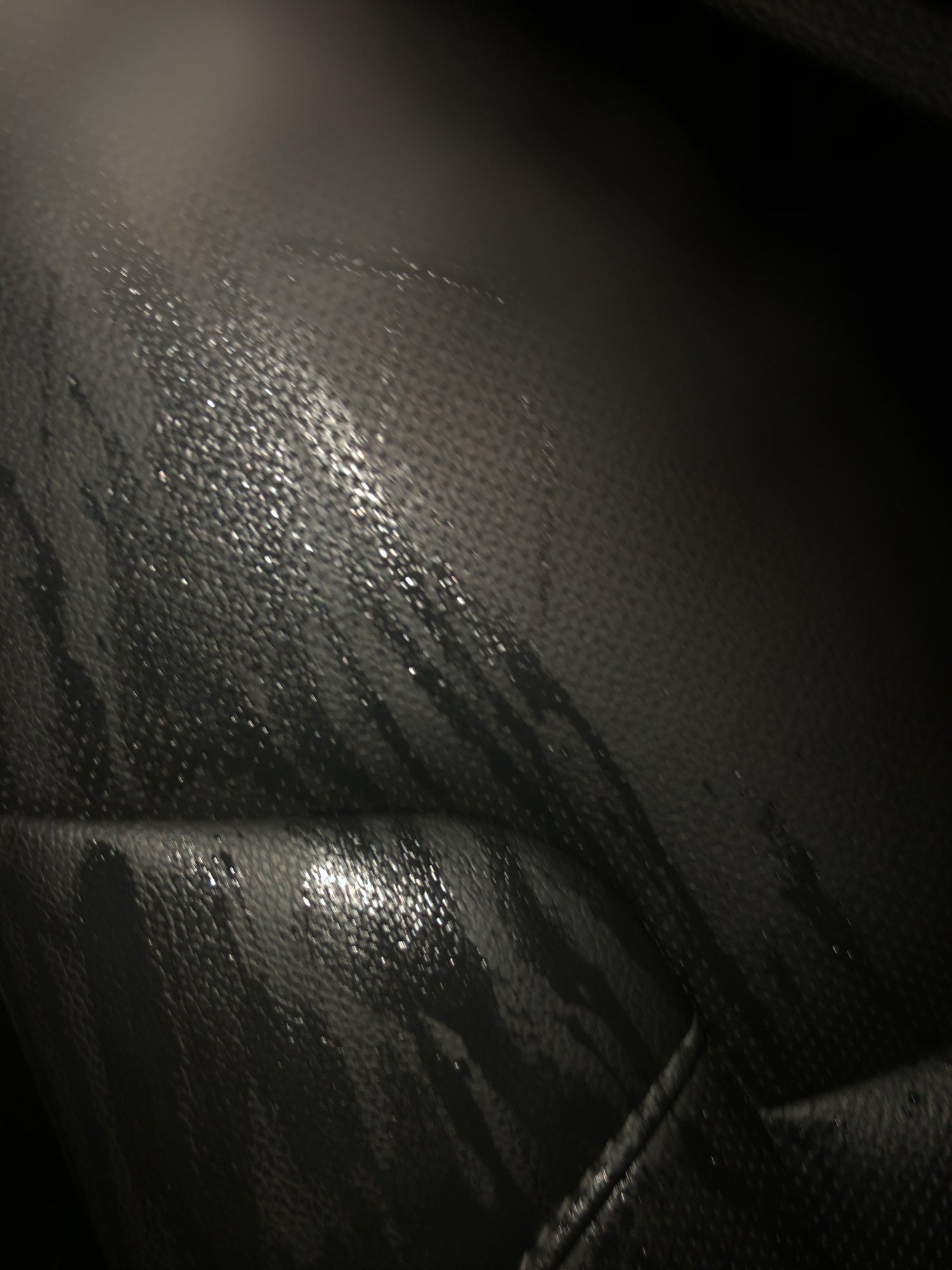

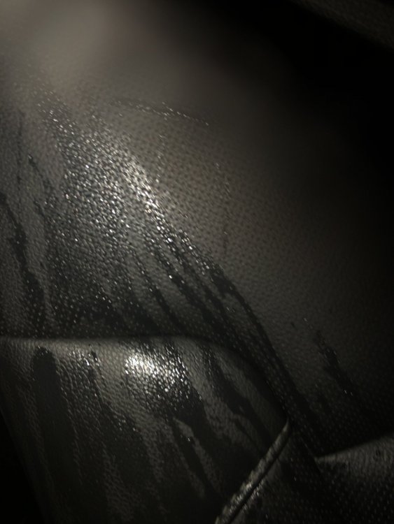

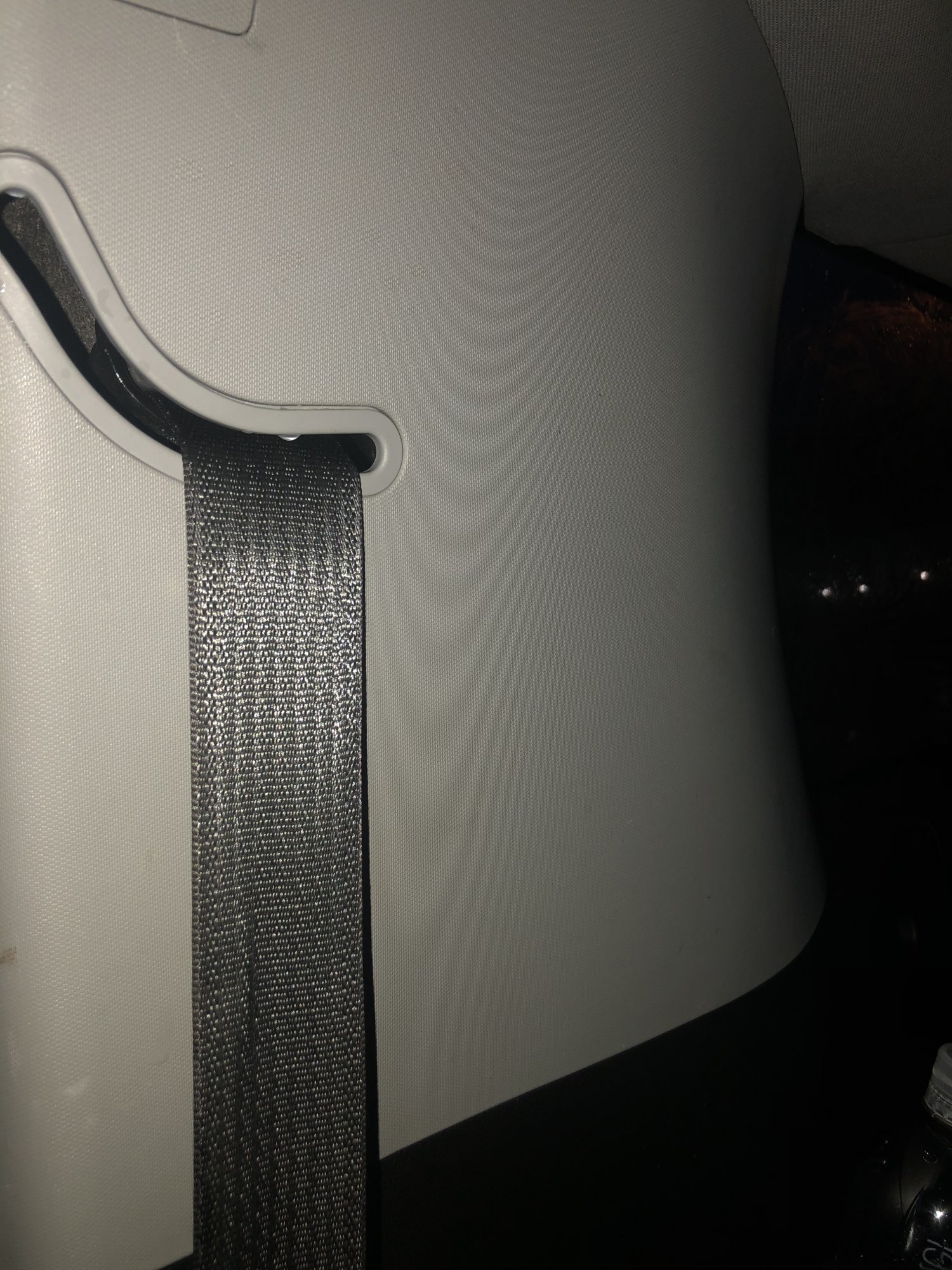

Leaking in seat belt area.
replied to another post...you're having the same issue. The leak is due to the fact the roofs are glued on, once it starts it will never be stopped. had this happen on a 2015 Tahoe without a sunroof. No dealer will be able to fix the issue, believe me i went thru it for a year with no luck. Found a dealer that took it in on trade, walked out with a new 2017 Z71 a year & a half ago, with a sunroof, no issues. You got a bad one like me & many others. Next will be the HVAC controls. You think the water is only in the second row, wrong. Its everywhere, behind the dash, soaked carpet padding, everywhere. Trade it if you can. I feel bad for you.
  • Replies 36
Same issue with our 2018 Tahoe we purchased new, 9 months ago. Less than 30 days after we purchased the vehicle was back at the dealer. The rear of vehicle was soaked inside. In the areas of the 3rd row seat belt guides. Dealership gutted inside of vehicle to perform water test. (Shouldn’t have been hard since we had 4 inches of rain the 3 days the dealer left it outside)Found that both rear roof seams on both sides were never completed when it was manufactured 2 months before our purchase. Seam sealer was applied and reassembled after a shit show with the dealership... few months later, back into the dealership with trim panels that were falling off, and again, a mobile swimming pool in the back of the Hoe. Vehicle gutted again, found another area of roof seam that was neglected to be sealed by dealer the first time. Headliner,carpet and almost all of the interior panels were replaced (broken on first repair) Fast forward 3 more months... Leaking again, this time from the studs on the right rear seam. 3 separate case reports open with GM, over 30 days in shop, trying for Lemon Law as GM said nothing can be done other than “let the warranty do what is there for”. Referred us to BBB

When I bought my SUV, it was perfect. Now it’s been to the dealer 3 times and after tonight’s rain, I’ll be taking it in tomorrow for the 4th....for the same recurring problem. It’s raining through the seatbelt behind the passenger side in the middle row. The last time it happened they kept it three weeks while running a sprinkler over it to duplicate it and couldn’t make it leak. The time before they told me the welds had broken in the roof from driving it. The time before it was a gasket under the GPS antenna. It was put on backward. Each time except the last they made me pay since it was past the 35,000 mile mark.
I have a 2015 Malibu LTZ with the exact same issue.  Seems to be only on the driver side seatbelt.  My car also has a sunroof, but i think the drain hoses are not near the seatbelts.  My car is out of warranty, so I am trying to fix this myself.
