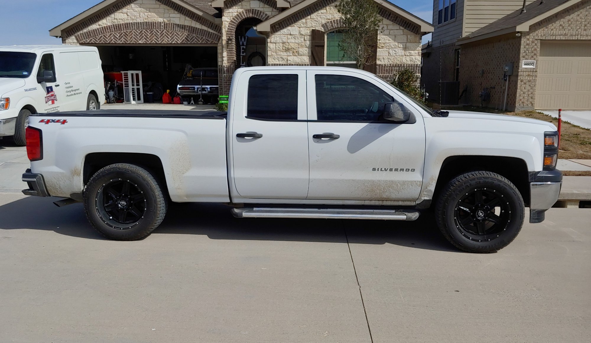

Side picture 1
Gorgeous trucks.
Im thinking about getting 5100’s to lift my nose up a bit.
These wont stress the upper ball joints, correct?

Bils don't change the angles that much that you would need upper c arms. Having them would be a plus them wouldn't hurt tho.eres my 14 wil Bils at max height bed loaded with stone behind the wheel wells.
