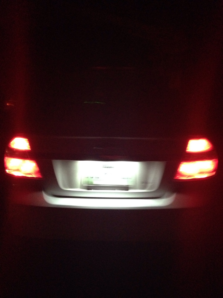

Zane, thanks for the review and write up. Where did you purchase the ZEVO 194 LED's? I can't seem to find the exact ones for sale anywhere.
We picked them up directly from Sylvania. However, I found them for sale on amazon, right here. :cheers:
I actually installed an earlier version of the ZEVO LED lamps (they were from Sylvania, they just didn't have the ZEVO branding yet) for My Little Aveo and the difference between the LEDs and the old incandescent bulbs were TREMENDOUS! I plan on doing the same modification to both the truck and our Suzuki very soon!
