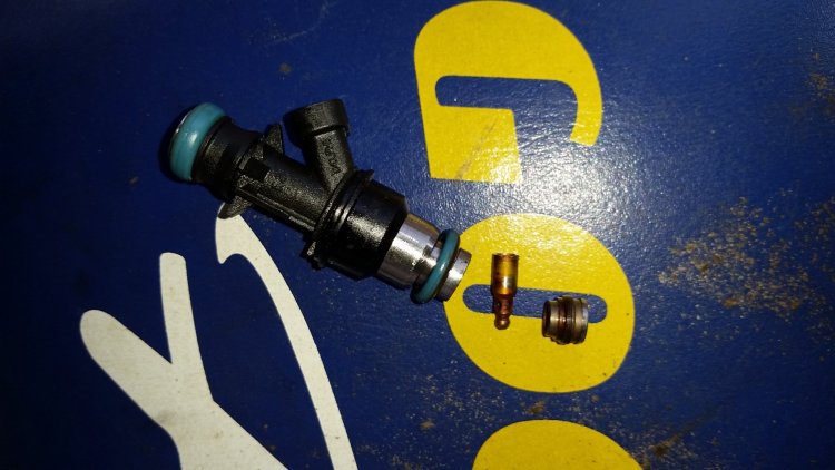

Well after taking the fuel rail off aND soaking the rear injectors I still wasn't getting any click out of at least on of the injectors, so I popped it apart to find it was rusty and varnished to the point of being stuck.  So I'm just going to order a rebuilt set.
