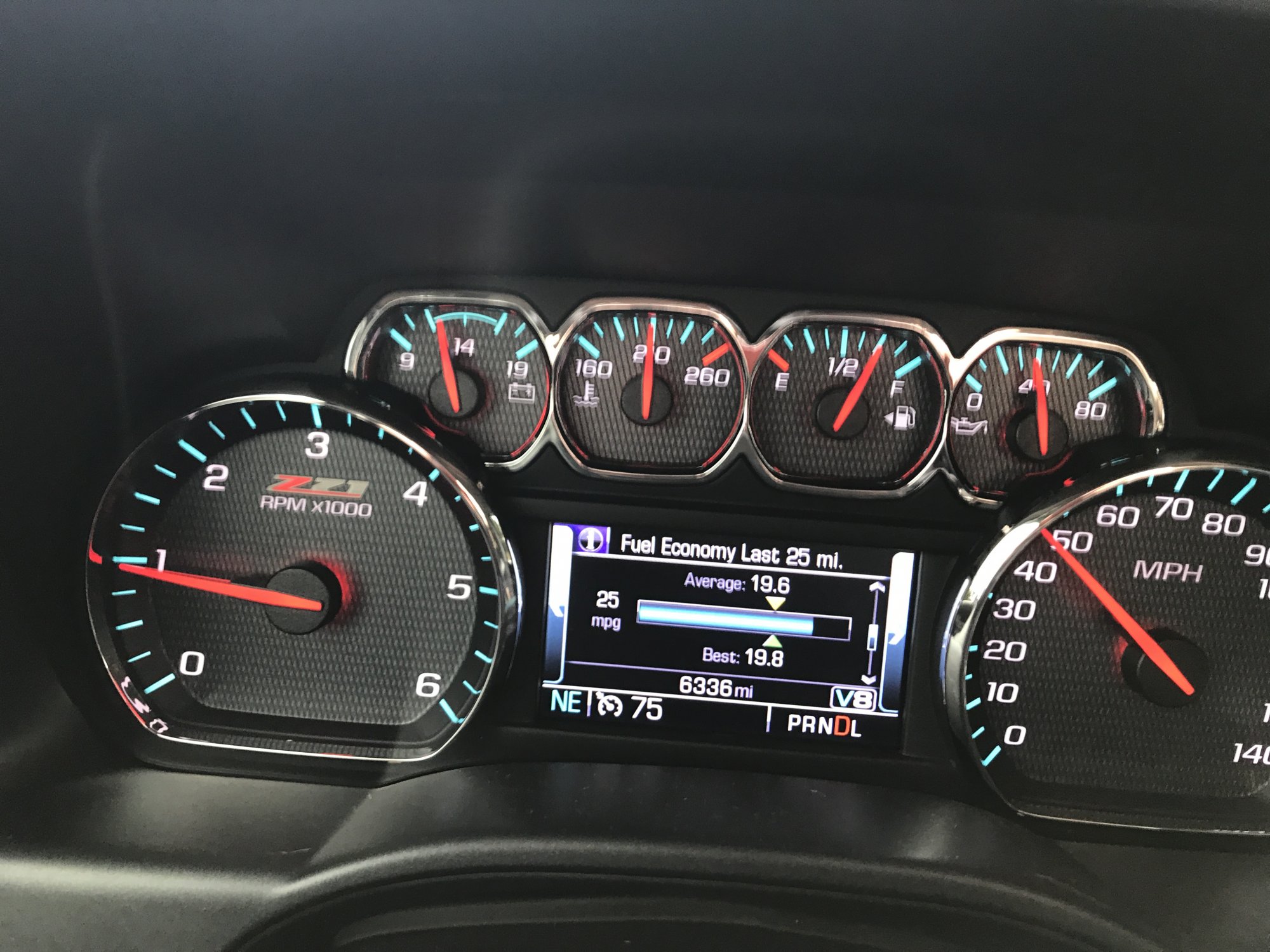

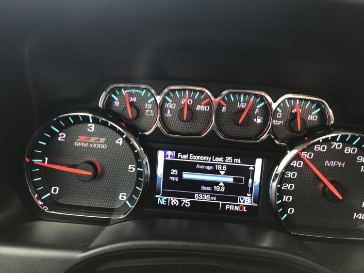

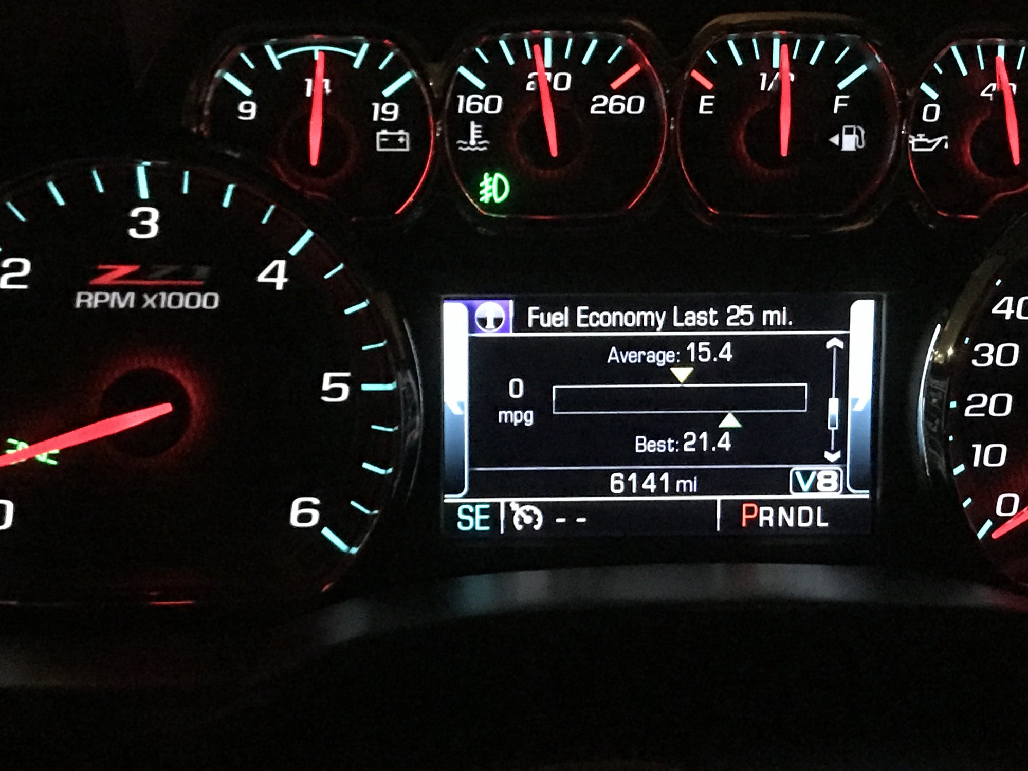

So this is the 25 mile average after around 200 miles. 1st pic is before 93 performance tune, 2nd is after the tune.  and I've been fairly heavy footed since the tune.  It's basically the same for all the fuel distances (25 & 50).
