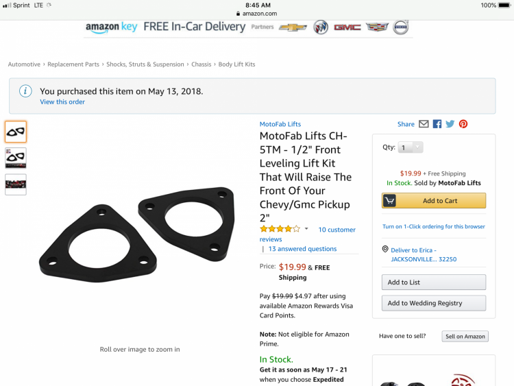

I ordered these top coil spacers because at first it’s all I could find.

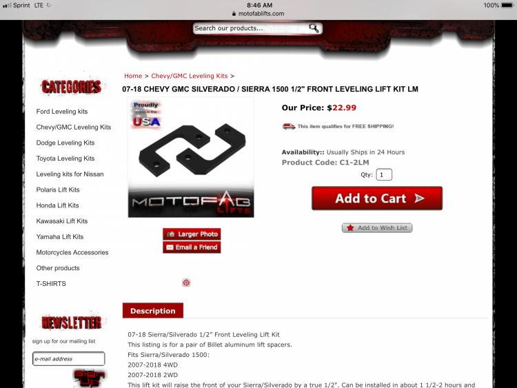

  Shortly after, I found these 1/2” motofab lower mount spacers which I have heard are much better and will mostly likely be returning the upper mount spacers and getting these.

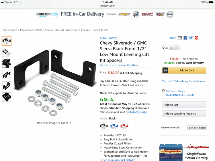

BUT, before I order the motofabs, I also found these hiding on amazon. Seems like a pretty identical product to the motofab spacers. I have some credit on amazon so that’s really the only reason I would buy these over the motofab blocks.

The Amazon kits questionable bolt quality would make me nervous.

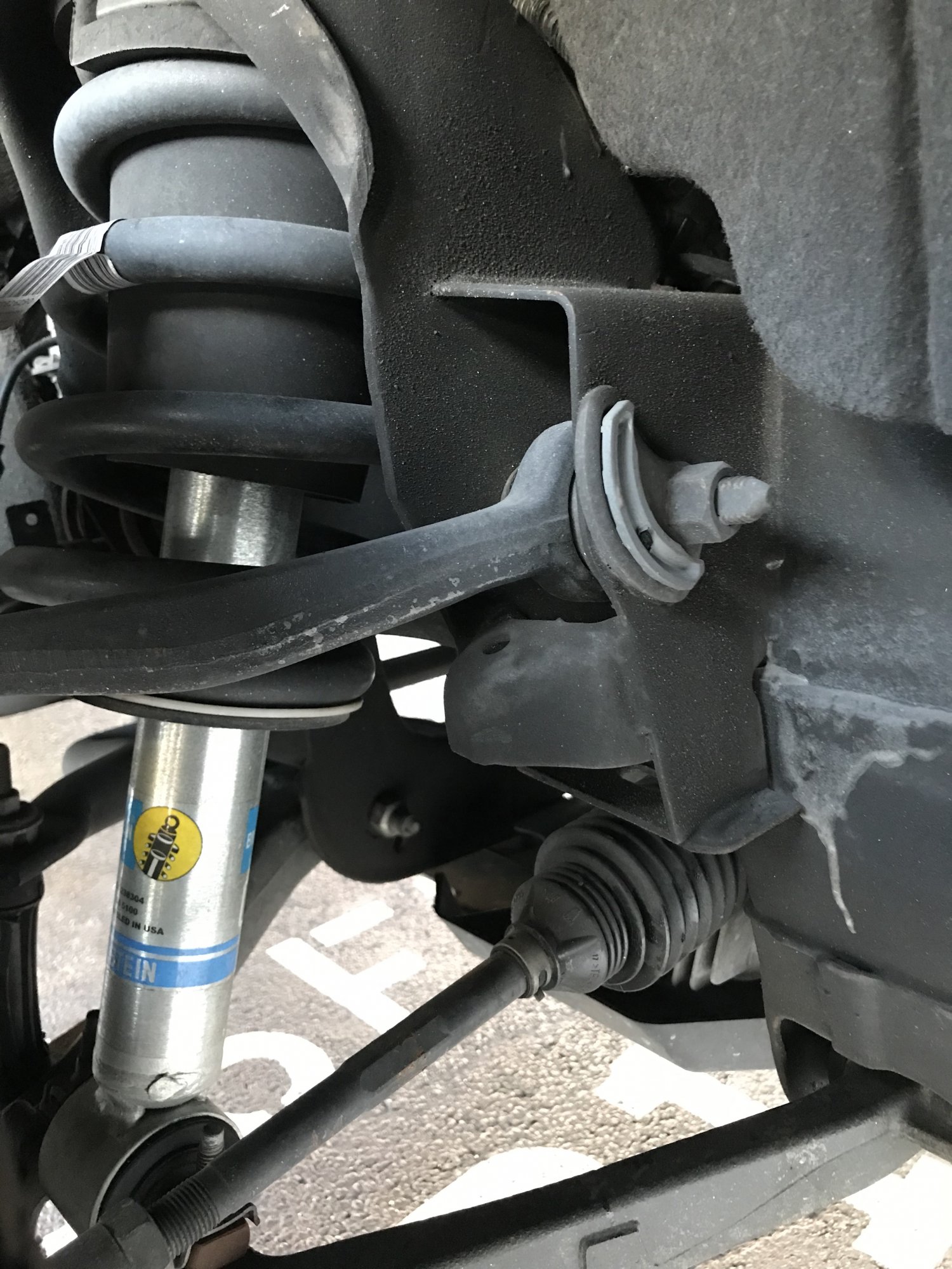

Agreed. And that’s definitely a major concern of mine which is why I’m just lookin for a little bit more. My angles are still what I would consider stock even with the 5100s. My last truck had horrible angles, I refuse to do that again. ??
Current angles with Bilsteins

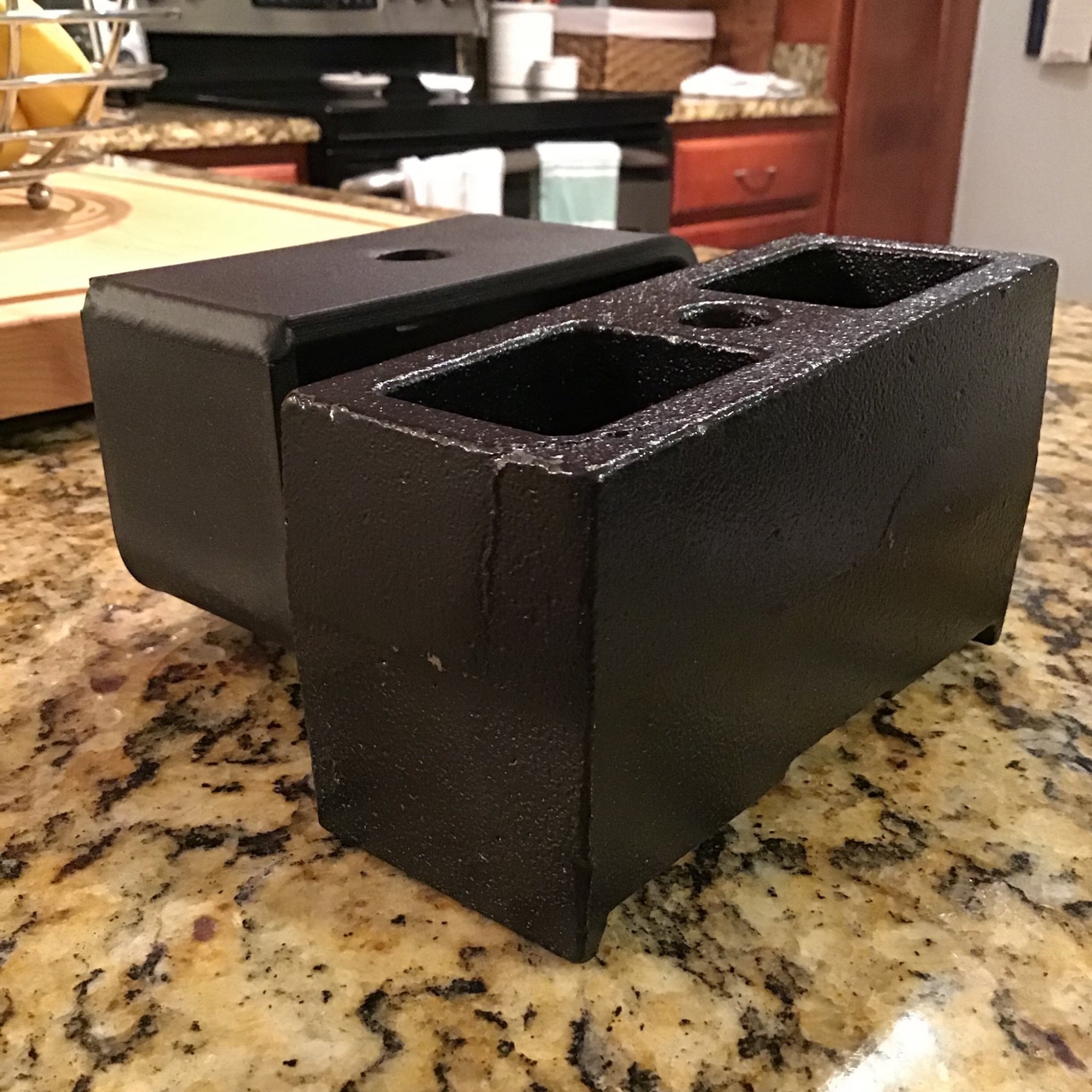

Block in the back is labeled as motofab 2” block @ ~ $50. Block in front is ready lift 3” block @ ~ $120. Look the same size to me ?
