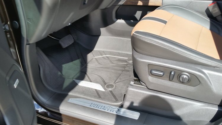

Installed the Premium All Weather Floor Mats which I Highly recommend.  They provide complete protection of the Floor.
Front #84333603
Rear #84333635
How did you get your rear box to fit on the mat?
   Steven
I removed the the rear storage unit.  Three 10mm nuts; two on Jack bracket and one anchor screw on driver side.  Installed the mat and only had to trim the two 1/2"H by ~ 5"L  ridge pieces from the mat on the passenger side to reinstall the storage unit flat on the mat.  You will also have to drill a 3/8" hole on the driver side mat  to match the location of the anchor screw location in the floor.

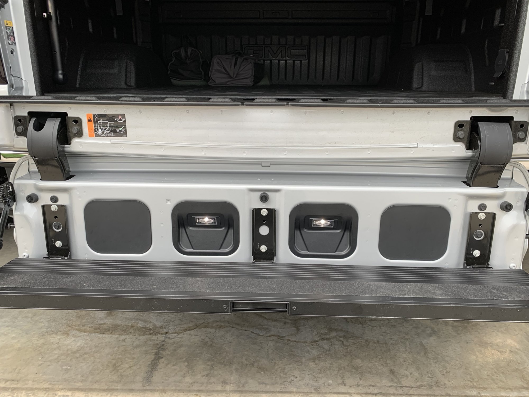

3 hours ago, Opiedeegs said:
How was the Install
and can you put the lights in the outer squares of the tailgate step
Install was easy.  A pry tool easily took out the black inserts.  Plugs into the plug that houses the light for the tailgate buttons.  I thought about putting them on the outer sides but felt that the wire might have been stretched to do so.  I prefer the center because that is where I would try to step up anyway.  The light does encompass the edges of the step though.  Just dimly
