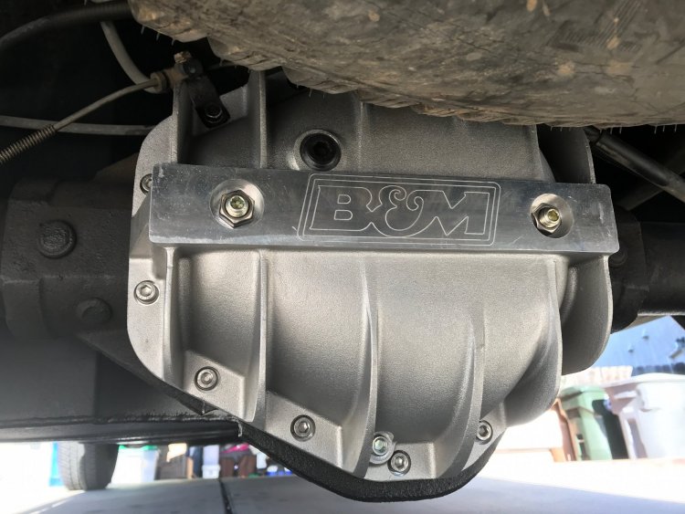

I replaced my diff cover recently.  The OEM cover was stained from oil leaks so I wanted to replace it as well as the leak (and I wanted the bling down there).  I watched the Bank videos as well and at least the B&M cover that I replaced was / is similar to stock as it is rounded on the inside, and not squarish like the ones he was showing.  Still waiting for Banks part 3 to come out...

I like that one, looks like it will do the job.

Added bearing support is good. Cheap insurance. I find that of more interest than cooling or volume increases. If cooling is a need these can be fitted with coolers/fans/thermocouples/filters and pumps.
The fill looks too high, it looks deeper so foaming shouldn't be a problem. Overfill would be a problem.
Not unless you use the factory fill in the diff housing.

I got it from Amazon along with the machine gasket.

Agreed. I got caught on this on my 2006 Jeep. Filled to the cover hole like I assumed it was in that location for. Turns out that was way too much and had gear oil out my vent tube for a week before I figured it out.
B&M's install directions cover this by stating to either use a axel housing fill hole if present, or on newer models, add the manufacturer's amount "plus .4 quarts". Or, more specifically:
Quote
17. Fill with factory recommended gear oil using the B&M Cast Aluminum Rear End Cover fill plug hole (See Figure 5). Add gear oil until oil runs out of the axle housing fill hole. NOTE: Add the correct amount of fluid as listed on your owner’s manual plus an extra 0.4 quarts on vehicles with the fill plug on the cover. Overfilling can cause differential problems.

Thanks for finding that info!  :)  I had the install done by a local shop so hopefully they read the instruction manual as noted.
That seems....wrong.  Now, how do you check fluid level?  Sure they save a few pennies, takes a less effort and leaves a nice flat spot to put their logo on the cover, but at the expense of basic usage.
I would suggest you specifically tell them to fill it as per the installation directions, as I wouldn't be surprised if the mechanic just slaps it on and fills it to the fill hole level, as that's how you check these diff's if they are full...
And remember to tell every single lube shop the same thing, if you take it to a shop for oil changes.  They may just top-up the diff as part of oil/lube service...
