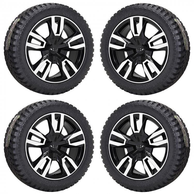

Can you post a pic of the wheels that you have that work? Thanks
Great lookin truck! But those aren't OEM wheels. I am looking at several sets of 22" OEM wheels from the 2014-2017 model for placement on my 2019. I'd love to retrofit with actual 2019 rims, but they're just not readily available yet, but I don't want to get a set of 2018's off of ebay or something to discover that they won't fit the 2019.
