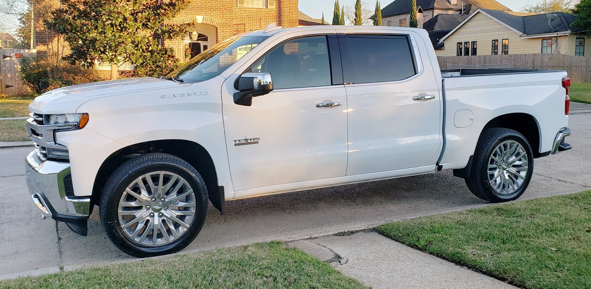

I just bought a 2019 Silverado LTZ with the standard 18" wheels. My intent is to immediately change the wheels out with a 22" set from the 2018 Silverado. I can see that the bolt patterns are the same, but does anyone know if the center cap bore size is different? Any other reasons why the old wheels won't fit on the 2019?
Did you get a chance to fit the 22" wheels on? I think that the 19301163 from 2015-2018 would look killer on a 2019.
I have GM CK157 wheels, 22". They do not fit on the 2019 because of the brake caliper. Looking for a 1/2" hub centric wheel spacer.
Yes! I found a set of take-off's from a 2019 Denali on eBay and fitted them to my new silverado, so I didn't go with an '18 wheel for fear that the off-set wouldn't work... but, I think it came out AWESOME with the 2019's... really improves the look of the truck, and I like the Denali wheels better than the High Country option for 2019. I paid $1995 on ebay with shipping included and sold my LT wheels on eBay for $900... so a real bargain at less than $1000 net cost for what has to be $5000 tires and wheels.
