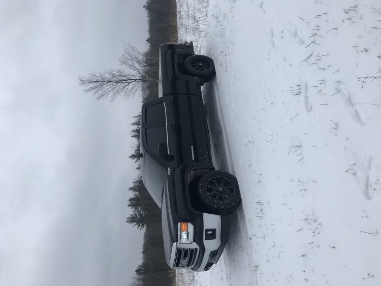

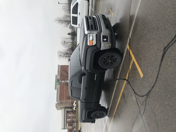

You are essentially talking about doing the RC 2.5" without putting the blocks in the back. I did that and my front and rear are within an inch now. I love the look! And to answer your question, no, there are no negative side effects.
Keep in mind the RC 2.5" leveling kit is the normal 2" bottom spacers with the .5" top spacer for the front.
