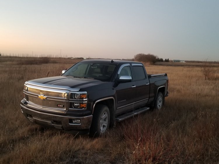

Hey guys, I want to work on my truck and upgrade it but i dont know what i should do. What are some things you have done to your engine and drive train to enhance performance and add durability?
*I drive a 2014 LTZ 5.3
