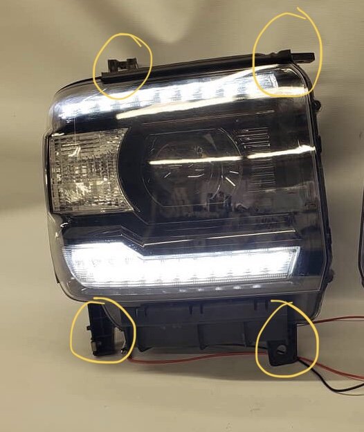

Hi everyone, I have a 2014 GMC Sierra that I'm looking to do headlight conversion to the 2016-2018 version. I'm seeing a lot of good deals on ones with cracked and broken tabs. I can get pretty handy with some JB weld and I figure I can perform some fabrication. I've never taken the headlights off so I don't know what all is going on back there so what tabs can I get by being cracked and which ones can be completely broken off?
You have 4 mounting tabs on the headlight. They all seem pretty important seeing there are only four of them. I’m not sure if I’m understanding your question fully or not. Are you asking which ones can be broken off completely and the headlight still being sturdy when mounted?
I was wondering which tabs I wouldnt be able to fabricate, like which ones are for adjusting

None of that tabs are for adjusting just for mounting.
Thank you sir... I’ll try and get one without broken tabs for a good price but I think I can definitely get by with one or two cracked as long as I fix them
Nate, was this a pic of your headlight?
I like the clear turn signal lens look and slight smoke/tint.
Yes they are mine.
Jeremy from the RetroShop built them for me
Klearz clear turn signal lens
color matched paint
FXr 3” projectors
diode dynamics switchback LED boards.
