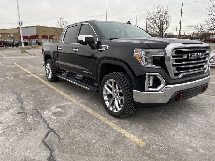

I just put on 2” spacers from RC. Loving the new stance. Until this whole pandemic subsides, this is in lieu of new rims and tires. Before and after pics

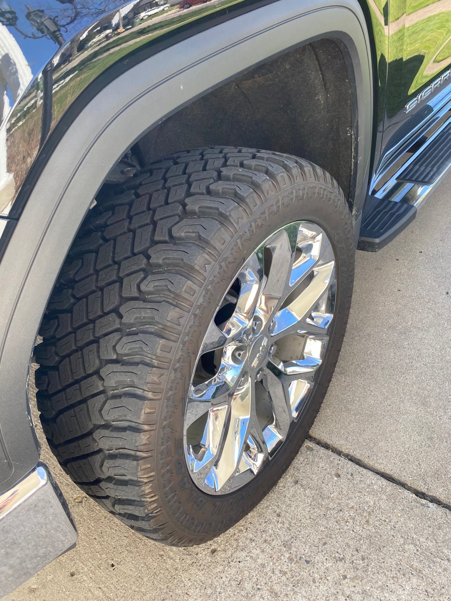

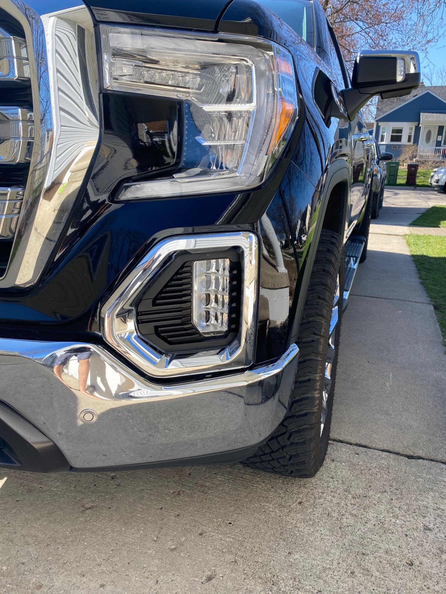

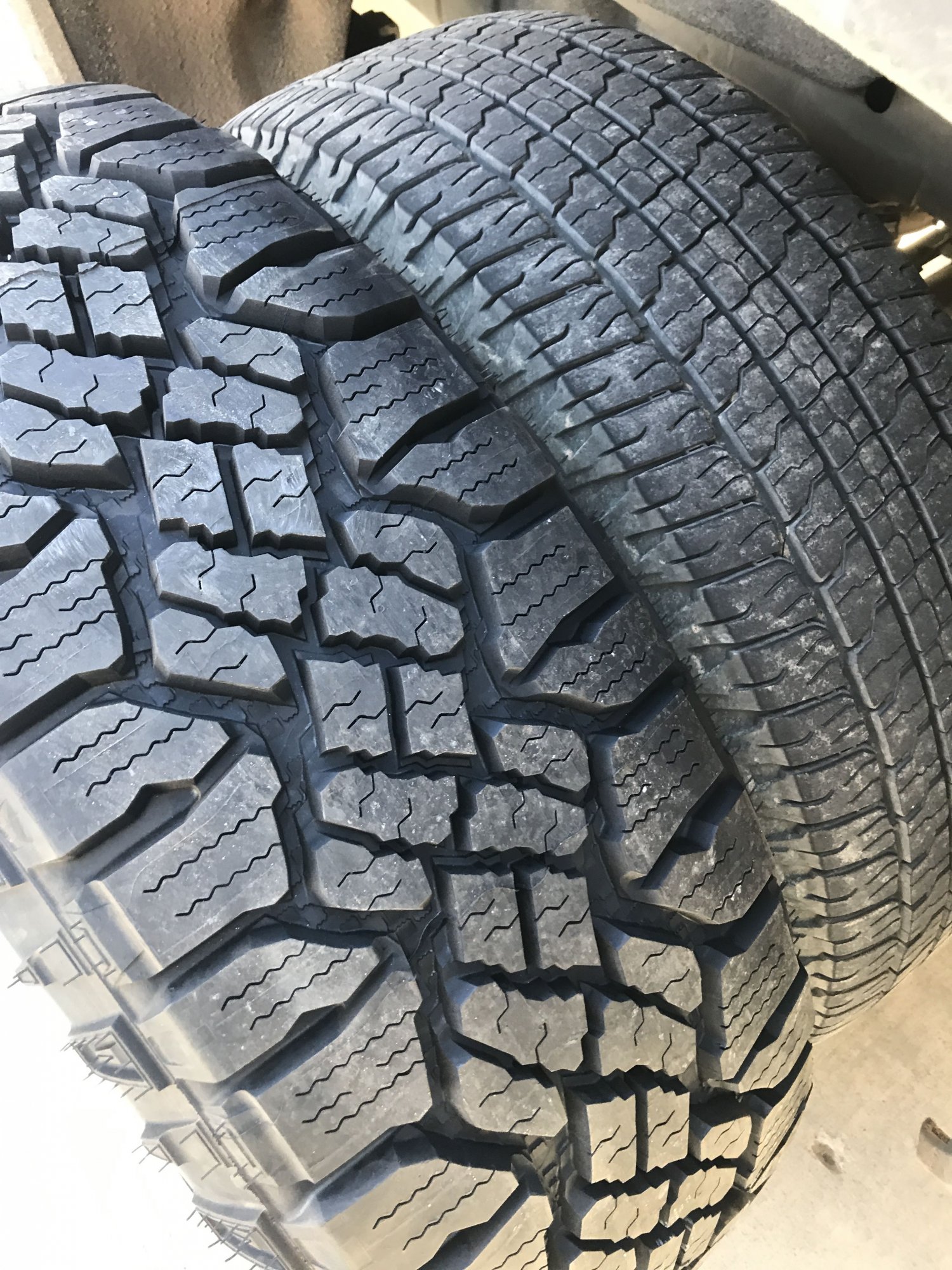

Factory 22's with Atturo Trailblade XT's 33x12.50 (Run small) with 1.5" level and 1.5" spacers

Keep an eye out for the side wall on those atturos. I ran that same size for a while on some stock 22x9" wheels on my previous truck and had issues with the sidewalls on 2 different sets. The tread life is great on those tires and once balanced they drove fine just the side walls started splitting after about a year of use and I tried air pressures from 32-38psi. Truck was a 2013 AWD Denali with a level lift in front. I did have the alignment checked after the level too. But also I never rotated the tires since tread wear was pretty dang even across all 4

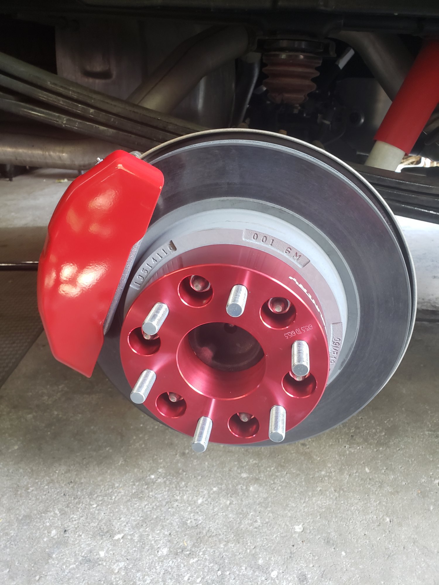

Put 2" Rough Country Spacers and MGR caliper covers on today. Heres a few before and after.
Some people seem leery of these because they are not hubcecebtric. But, the gm hub has a big ring that fits on the inside, so I dont think it's a an issue.  Torqued everything to 140 and just took it out on freeway at 80mph. Smooth as can be  it could be my imagination,  but it feels a little less floaty on highway as well.
Mgr caliper covers, I don't feel are worth the 170 price tag. Front fits well, back is a little shaky. And they are like 3mm thick.  But they went on anyways.

Mgr caliper covers, I don't feel are worth the 170 price tag. Front fits well, back is a little shaky. And they are like 3mm thick.  But they went on anyways.   Can only post 1 pic for some reason.
Are these stock tires and wheels with spacers???? Thanks
Stock 20"wheels with 285/60r20 tires.
